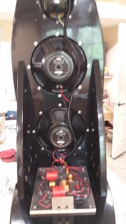

I need your help please.  Below you will find a OB speaker I built.  I am not happy with the bass output.  I think I made a mistake of using the Eminence Beta 15A rather than the Eminence Alpha 15.  I am considering either trading the woofer to the Alpha 15 or adding an active crossover.  I would appreciate members recommendation on how a can improve the sound (particularly the bass response) on my OB build.
Thanks for considering to help.
I built the following open baffle speaker.
<image.jpg>
<image.jpg>
Using the following components:

Are you using one amp or two (three)?
I would use a separate amp with gain controls for the woofers; like Crown XLS xx00 / xx02 or a pair of plate amps.

Hi,
I built something very similar to yours a few years back. My suggestions both for good sound and optimal costs in mind.
1. Between the tweeter and mid-range use passive xover, fairly cost-effective and not too difficult to design
2. Active 2-way using 2by4 MinidspHD, the one channel driving the Tweeter and mid and the other driving the 2 woofers in parallels, this way you can control the frequency response very easily. The sound is very good indeed.
3. The tweeter and mid-range use tube or solid stage to drive them, you don't really lots of power, an EL84 push-pull(not expensive) or even a single-ended tube or prefer solid-state use LM1875 or 3886, all these amps sound very good.
4. The bottom end woofers use a high powered digital amp, so many around and cheap too.
BTW the ALpha 15 is not really a real improvement on the Beta 15. You need to spend more money to buy a better 15 or even 12in woofers. Look at the SB Acoustics 12" or 15" open baffle woofers, I haven't heard them you still need to do more research before buying. For my system my woofers are my weak link, so spend more money on getting high-quality woofers.
Your speakers should sound very good once you finish with them. Huge sound stage, great clarity and openness.
