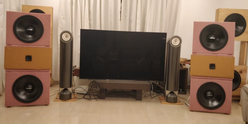

Unfortunately there aren't any good OB setups nearby. I prefer learning while experimenting so I built my OBs with PRV15W1000V2 woofers and FaitalPro 3FE25 FRs. I've played around with the crossover and also tried some EQ'ing. I'm impressed by how they sound. They are more "fun" and have a 3D sound compared to my commercial BLH speakers. The proven designs (MJK, Linkwitz, Manzanita, Betsy, Troels etc) I came across were based on drivers that are not locally available (In India). So I decided to take the plunge with a rather simple FAST/WAW OB.
I'm hoping these questions will help others too. Very frequently I've seen misconceptions being cleared up when very basic questions were asked and debated. BTW, even links to good material is fine.
Here is a pic of what I've got. It's still work in progress. The ones at the back were on loan from another DIYer.

I'd suggest changing the speaker so its a MWW design instead of a WMW design.  Having that midrange driver on top of the speaker and closer to ear height will improve the sound, IMO.
Also, you have the midrange driver placed in the exact middle of the board, that's bad from a diffraction standpoint.  Offset the driver so it's different distances from the top, bottom and both sides (ie, it's as non-symmetrical as you can make it), this will give you better response and much better imaging because edge diffraction will be randomized.
Here's what I mean (but in a box speaker, obviously).  Look how the mid/high frequency driver is offset, this is what you should shoot for:

@Tyson, the whole frame is tilted so the tweeter fires directly at you. Regarding avoiding edge diffraction, yes I plan to try that.
