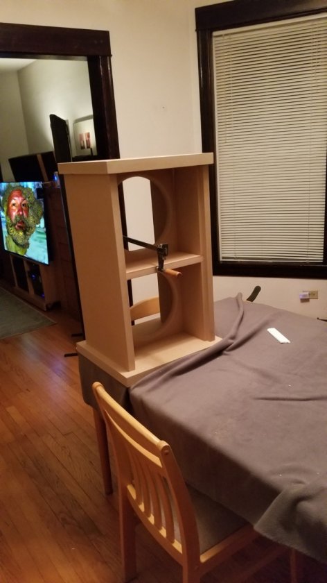

I have a pair of MG 3.6's which I have tri-amped using a DEQX.  I have gotten a 2nd DEQX to do subwoofer duty, and I have gotten the dual twelve H-Frames and have the drivers and servo amps on order from Rhythmik.
I am merrilly moving along here.
But I have a question -  why an H-frame?  Why not just put the woofers in a flat sheet ( or SLAB ) of wood, supported by a truss running from the top of the slab to the ground to hold the slab still?
Doesn't having a H-Frame increase the amount of mass that gets excited by cone movement. which then "speaks back" this energy - smearing the timing?  It's not an enclosure but it's a fair amount of mass.
Just curious.
Early B.
