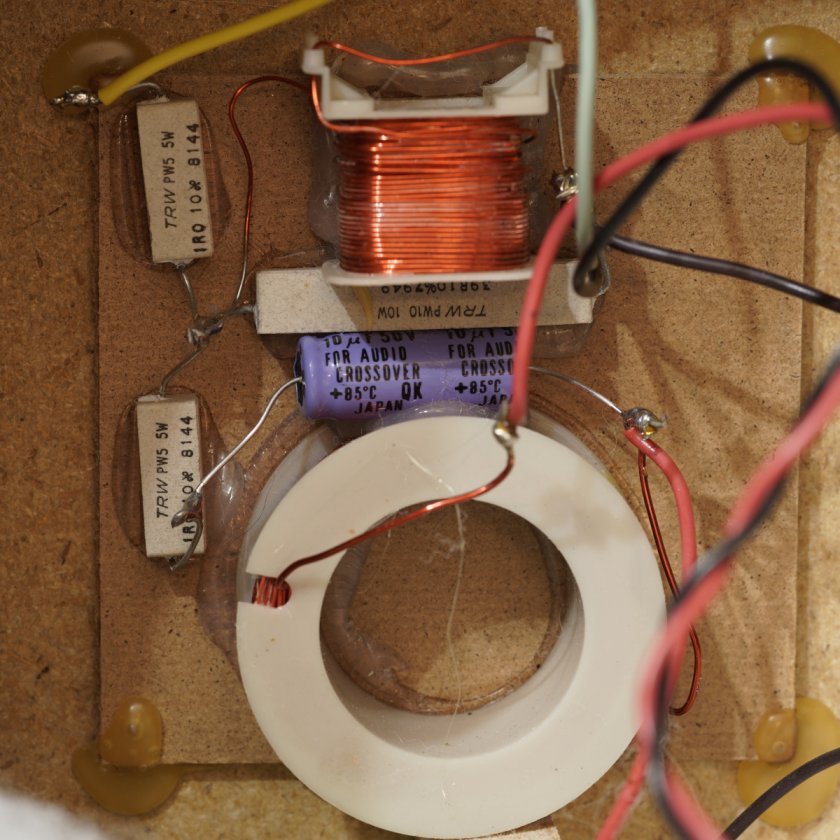

I have run in to a bit of a problem identifying the parts on the crossover. It is a very simple crossover with only 6 parts per speaker. These are two way speakers with one woofer and one tweeter.
The capacitor is not a problem it is an electrolytic 10 uf 50 volt generic, I plan on replacing this with a Gen I Sonicap 10 uF 200VDC Part# 506741  or Audiocap Theta 10uF 200VDC Part # 426650  (Sonic Craft part numbers)
There only two resister values involved, presently marked “TRW PW5 5W 10%, 1R0 8144”, (5 Watt 2 Ohm?, from what I can gather, could use some help here is anyone knows how to read these markings on the older TRW resisters)
The second one is marked “TRW PW10 10W 10% 39R 7949” (10 Watt 39 Ohm? Same request here if I am reading these marking right)
If I have the right values I plan on replacing these with 1.8 Ohm Mills 5 watt MRA-5, Part # 626130 or 2.5 Ohm Mills 5 watt MRA-5 Part # 626145 (Sonic Craft part numbers again and they don’t have a 2ohm version) and 39 Ohm Mills 10 watt MRA-10, Part# 630369
The inductors I cannot find any markings on so am at a complete loss here. I have contacted the manufacturer (Now called Axiom) but they have not kept any specification records from that far back.

1R0 indicates a 1 ohm resistance.  39R0 is 39 ohm.  The only way to identify the inductors is find a value marked somewhere or measure them.  There is a slim chance posting pictures might reveal something.

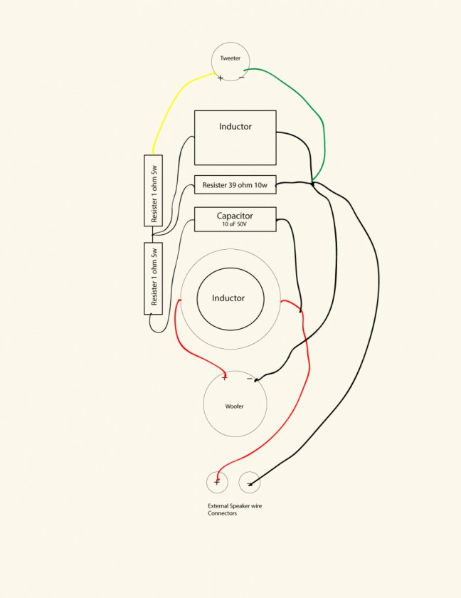

Pictures help as does a crossover schematic if you can draw one. Since R, C, and the crossover frequencies are known, I think one could determine the L values with a schematic.
The marketing brochure says they are a three way speaker but they have only two drivers plus a passive radiator so I don't know what the 70 Hz crossover is doing.

Added a photo and visual drawing of the circuit (Electronically and software handicapped, appreciate if some could draw a proper circuit diagram for me)
I am also wondering why there are two inductors and only one capacitor on this crossover?

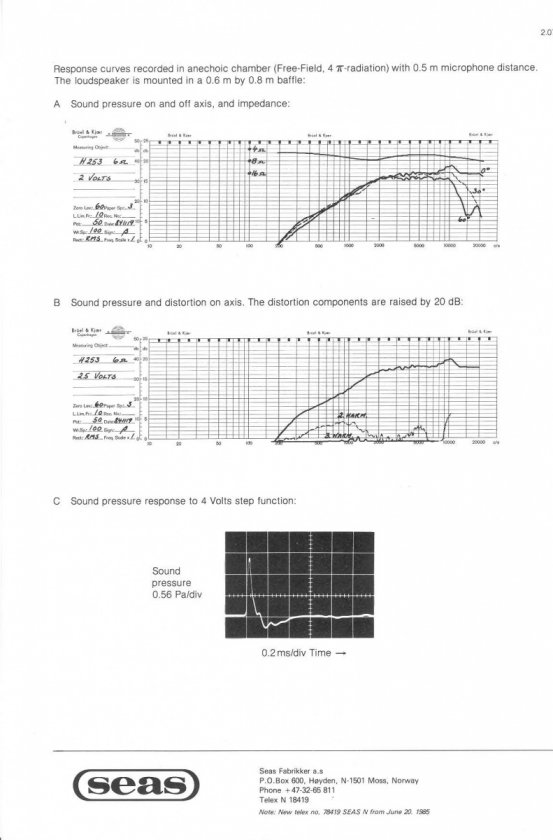

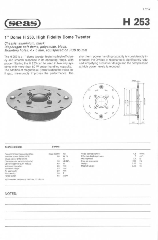

I have also found the spec sheet for the tweeter which is an SEAS H 253 1” dome and will attach below.

Although the brochure states impedance at 8 Ohms (nominal?) for these speakers, the spec sheet for the tweeter states it is rated at 6 Ohms. I measured it to be 5.56 Ohms and the woofer at just under 5 Ohms.
Is this being accounted for in the original crossover design?

From your diagram it appears that the electrical crossover for the woofer is a single inductor. This is a first order crossover. The inductor is a low pass filter. According to crossover calculator I found, the formula calculates the woofer impedance to be 3.4 ohms if the crossover frequency is 70 Hz.

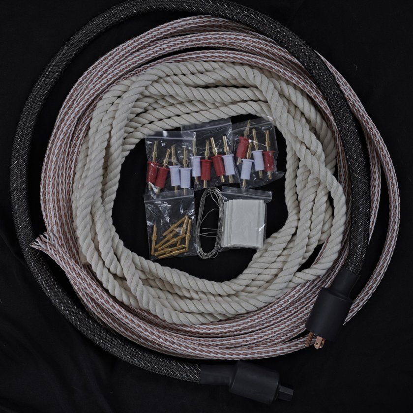

For this project I will also be upgrading wires and connectors and will be going with these items from GR Research. I will be adding the Electra Tube connectors on the amplifier side as well.
24 Strand DIY Speaker Cable - 23 feet
DIY Audiophile Speaker Cable Kit – electra cable tube connectors both ends for a pair of cables
Electra Cable Tube Connectors – 2 pair for amplifier side connections.
B24 Power Cable 4 Feet
Received the parts from GR Research, (Very high quality components)  still waiting on the crossover parts.
