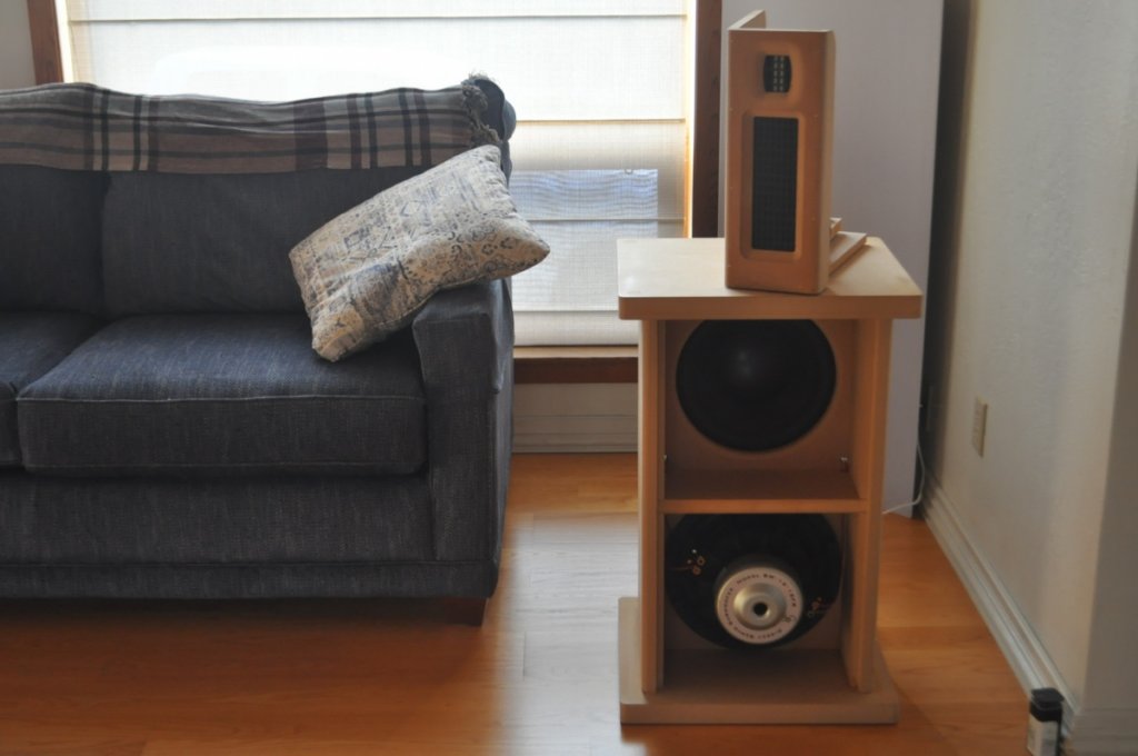

rtate
@mkane,  what is that speaker in the first picture ?
Hobbsmeerkat
  • Posts: 2741
thats the SuperMini, Danny's all planar monitor.
So long as you can get your hands on some BG Neo10s you can still build a pair.
