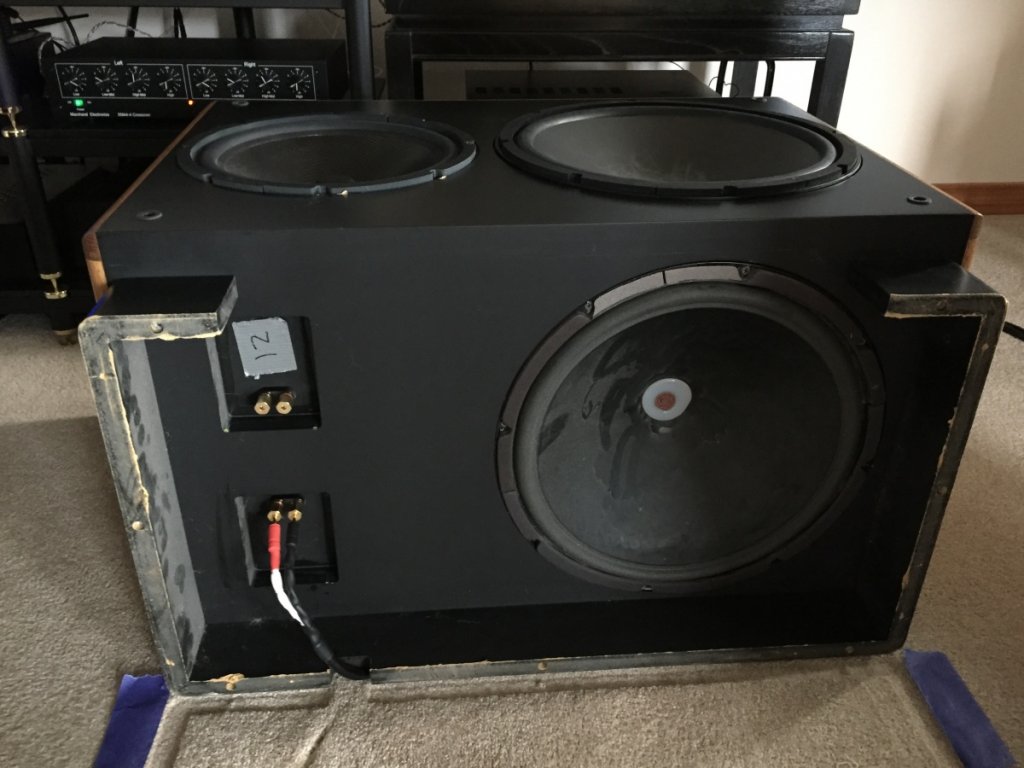

I have the large subwoofer, installed and set up 30 years ago by Brian, rip. I no longer have any documentation, and am moving it to a single L/R channel power source. How do I connect it? Input to the bottom two of the lower posts and bridge to the lower of the upper set? Thanks for any help. Iraj.

Thanks George, and sorry for the delayed response, but I may have confused things with the title of my question. I have the Large subwoofer, with only one active (12") driver.  The 15" is passive.  I've got two sets of input posts and two sets of output posts, totaling 8 posts.  If I remember correctly, a two-channel stereo amplifier is to be connected to the subwoofer as follows: Left to one set of inputs and Right to the other, with the corresponding outputs going to the Left and Right speakers, respectively. My dilemma arises from my use of a 3-channel amp, only one channel of which is going to the subwoofer.  I don't know (1) if I will damage anything by bridging the two sets of input posts, and (2) if it makes a difference which of the two input sets I use if I don't bridge.

Iran, I believe the driver is a dual voice coil. Yes you can use jumpers between the two inputs. I have the same subwoofer, that’s the way I run mine. Good luck

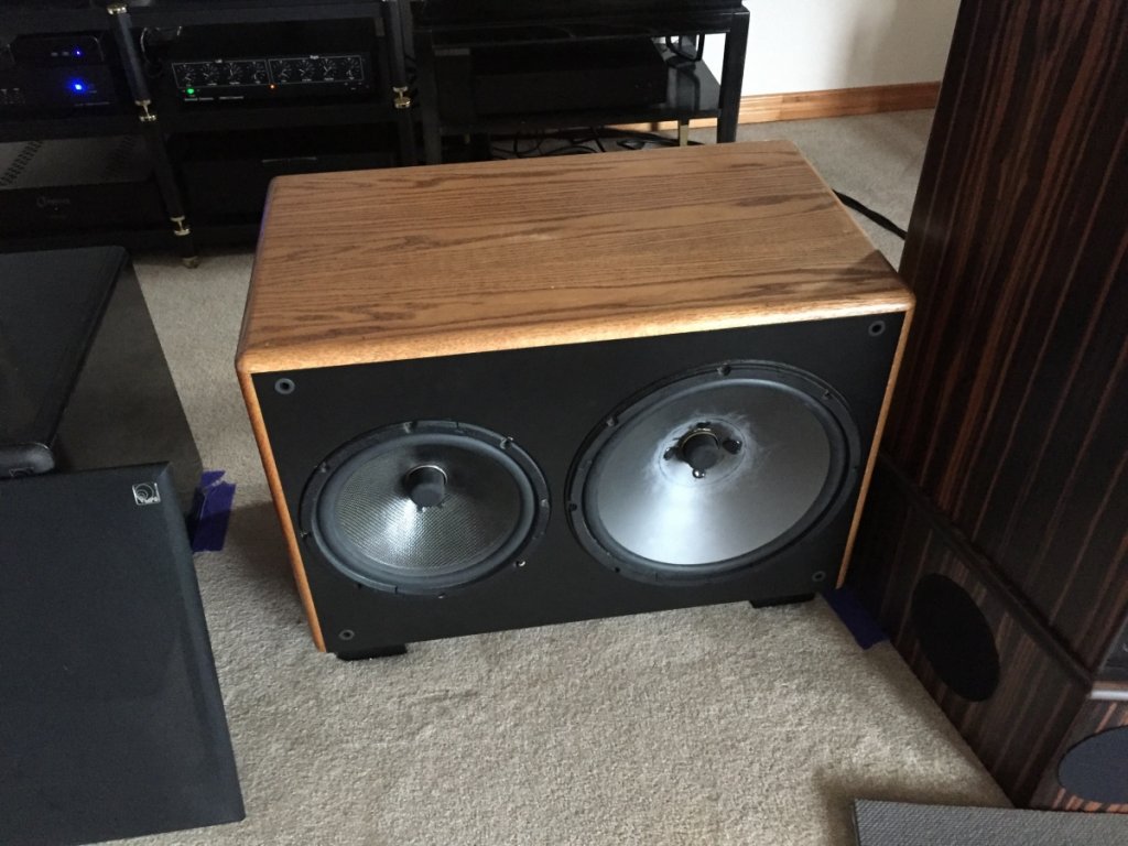

PS: I looked at the passive cone for the first time in >30 years, and see the foam surround is deteriorating. Have you tried to re-foam?  I’ve done smaller speakers, and the process is simple, but getting to that beast seems a chore. Any thoughts on that task?

You need to remove the base, hopefully it’s screwed on, this will give access to the 15” passive radiator.
I replaced mine with a rubber surround, it will last much longer. Also I will give you a link to vitrify your passive radiator, just scroll down to the instructions. Good luck
