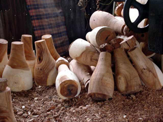

This is the raw materials for the original nOrh drum cabinets. Monkeypod, or rain tree wood is plentiful in Thailand, and is used to make the thai drums that originally inspired the nOrh speakers. Early drums had problems cracking outside of the Thailand climate. nOrh modified their manufacturing by baking the drums for at least a few weeks in a kiln and letting them sit before finishing the drums. They also replaced all cracked drums or credited for an upgrade...

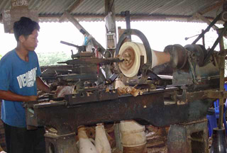

The log sections are turned on a lathe to shape the outside, and then to cut out the inside. The drum walls are 1".

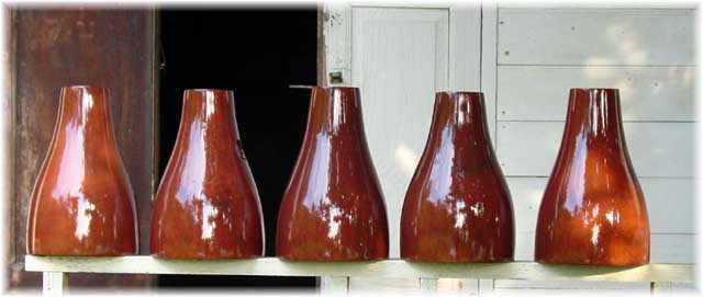

Here are some 3.0s. Although different stains were used, the wood is the same.

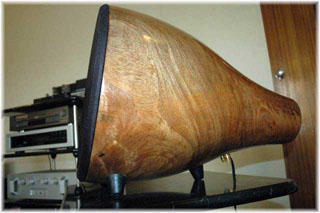

This is the 5.1 with a Walnut stain.

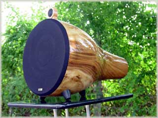

This is the 6.1. An exotic looking speaker!

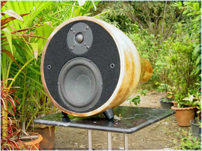

This is the 7.0 with the Scanspeak drivers
