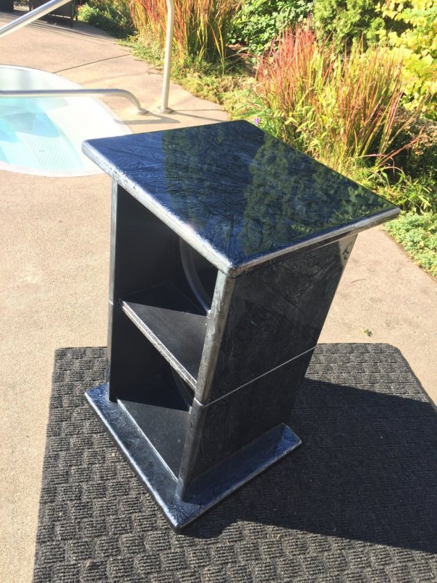

I lurk on here, but can contribute to this. I had my speakers painted by a friend who paints vehicles. I can confirm what others have said in that it requires a lot of preparation and sanding to achieve a mirror finish. You can see some of the process I went through here - https://www.audiocircle.com/index.php?topic=152363.0
Knowing what I know now, would I attempt this myself? Probably not. My friend is pro with a lot of control over spraying, with a whole shop set up just for painting. A single gun is over $1000, and house of kolor paint, marbilizer, and clear coat was probably $400. He also spent a ton of time power polishing the clear coat. However, I am very happy with the finish, and a few years later they're still perfect.

Thanks. Looks great, almost like marble.
