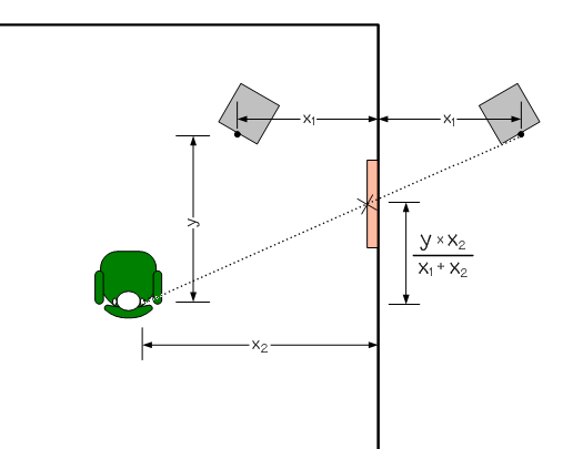

My first thought was that by the time you measured all the distances you could have found the spots with the mirror in less time!
Perhaps, but I've become more OCD in my old age Best,Anand.
If you are really OCD, you measure, then do the calculations to be absolutely sure! Of course, all results are in an Excel spreadsheet. [Disclaimer: I'm guilty as charged]. Thanks Anand. Both the Great Room Mode Calculator & 1st Reflection Points Calculator are very cool.
There is no reason to use metric. You can input the numbers in feet/inches or cm/meters. I do it in inches, works fine.Best,Anand.
I measured inches and converted into cm!It only took a few minuets longer, but the results were worth it. Using a mirror I got the first reflection point to the outside of the driver. What I didn't get with the mirror was the reflection point from the inside of the opposite driver. I had a 2'x2' area covered, and now it's 3'x2' placed horizontally.Chris
