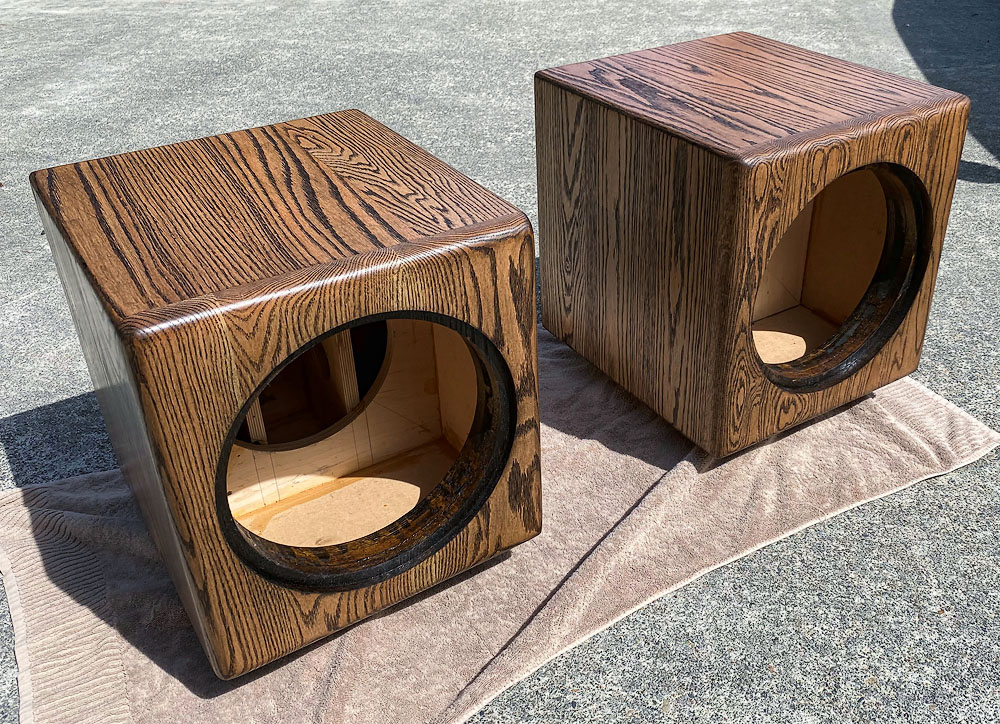

Much better result. The harsh direct sun accentuates a golden brown that doesn't show in the house, it looks darker and closer to an ebony stain.
I did pick up a random orbital sander but have to say my trusty old Porter Cable 505 works much better. The 5" feels like a toy.
I would have liked to try stopping at 120 grit in order to soak up more stain but I am happy with 180.
I have never worked with DuraSeal Quick Coat Penetrating Finish before. It is a stain but includes filler and doesn't even need a finish coat. I will use one though, just haven't decided what to use yet.

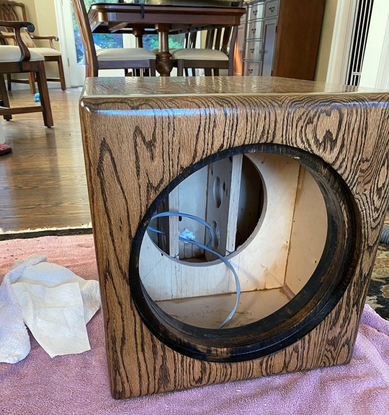

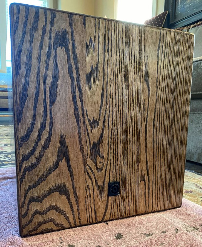

Installed the Neutrik speakON panel mount connectors and waiting for the silicon to cure. Very happy with the stain match to the floors. This is testing my patience. I sealed the edges where my hand would fit although I probably didn't need to, especially with the oak boards glued over all the edges/seams. I did want to be sure the speakON hole was well sealed.

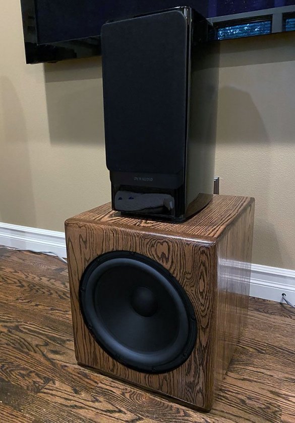

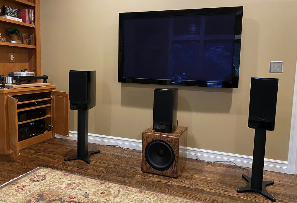

Both subs finished and connected. Still need to run set up and calibration on my Preamp and with Home Theater Bypass, then on my AVR but this is a 2-channel weighted room.
