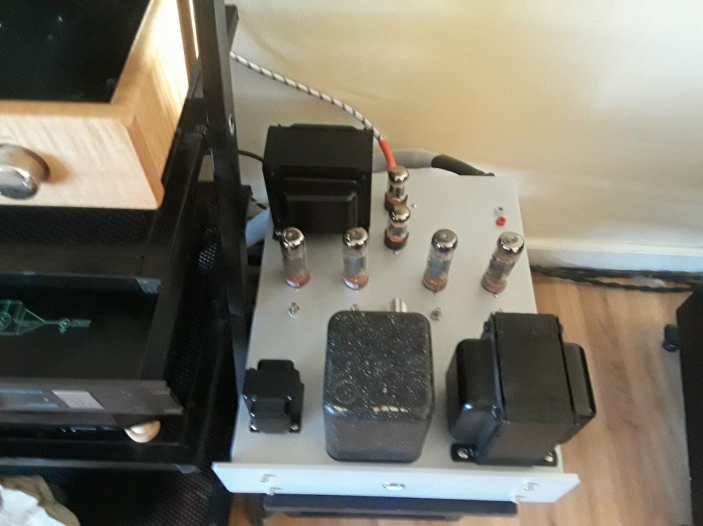

My first view of the amp.  I knew I was in for an amazing experience with these things!
The circuit layout is electro-industrial art!
I was puzzled by the absence of any ginormous capacitors.  As Charlie explained, an
audio circuit that has high enough voltage doesn't need much capacitance...and
provides for faster, more dynamic sonics than high capacitance circuits.  The
realization of the truth of that statement would be a spine tingling experience!

No, Charlie self described himself to me as "off the grid".  In my opinion, that is a reflection of his tremedous humility.  In any case, he communicates by phone only, and to receive his phone #, Charlie asked me direct folks to contact Danny Ritchie here on Audio Circle through PM.  Danny and Charlie have been close friends for a long time; first class gentlemen both.
I apologize for the cruddy photos.  I'll seek to get some better ones using a better camera to post soon.
