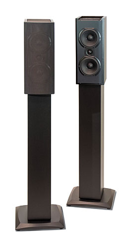

I am a fan of Triad speakers, you may not have heard of them but home theater speakers is all they do. Triad is sold through a professional dealer/installer network. I have 2 Triad OnWall Bronze Surrounds and 4 Triad InWall Bronze/4 Surrounds as my in-ceiling Atmos speakers. They work very well with my Anthem AVM 60. The speakers never call attention to themselves even though the living room is filled with sound so your attention is always on the action on the screen.
Triad has a balanced sound, the opposite of Klipsch. I stayed with the Anthem ARC Genesis curves which you can easily tweak to make a custom profile based on your room and hearing preferences.
The Triad InRoom Bronze or Silver LR-H would work out perfectly in your situation. The speakers have a clean classy look, you can start with 4 and 6 would make a totally awesome sounding room.

An in-depth review of the Triad Bronze LR-H, price is $1000 each.
https://www.soundandvision.com/content/triad-inroom-bronze-lr-h-speaker-system-review

I haven't heard the latest Paradigm speakers. Based on the Stereophile review the Triad speakers don't have the rising high end response typical of Paradigm. The Anthem will compensate and try to even everything out.
Regarding putting bookshelves on their backs, it sounds fugly to me. Up firing Atmos are supposed to keep a tight sound focus up to the ceiling, beaming the sound so after the bounce you hear the sound coming from above. Bookshelf speakers might have wide dispersion, just the opposite. Sure they would work but I doubt you would get a good bounce, just a big sound bubble.
