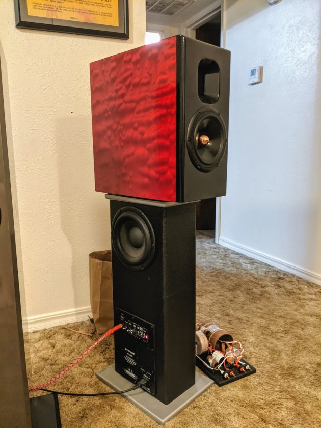

Still, I should be prepared for the future.  :D So should I make the component board fit on the outside, so it's easier to get too or can handle the larger components?  Probably. What about speaker stands? The small units with the bass woofer look good but are no longer being made. The double trouble would be a nice option for sure. But I'd really need two and my wallet is thin from XMAS stuff.

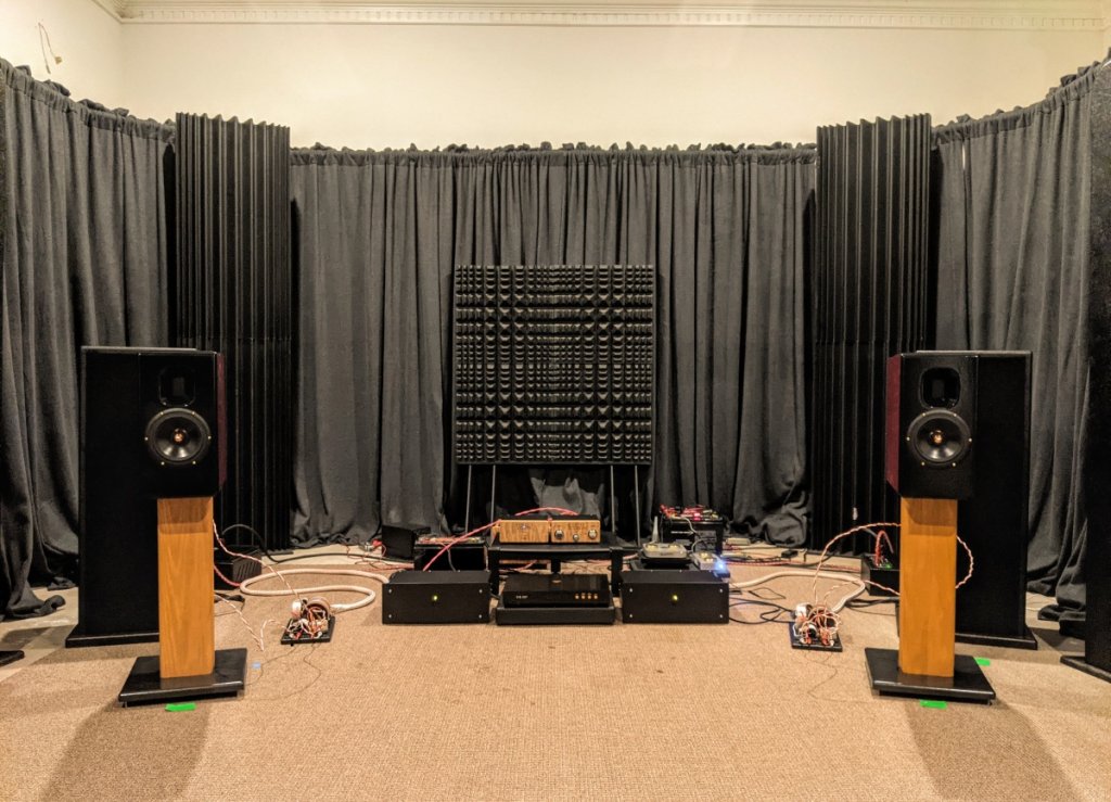

These are nice looking stands as well and would allow me to mount the crossover easily on the back of the stand. I've also seen some other really nice looking speaker stands in this forum that you all have created. So many choices.

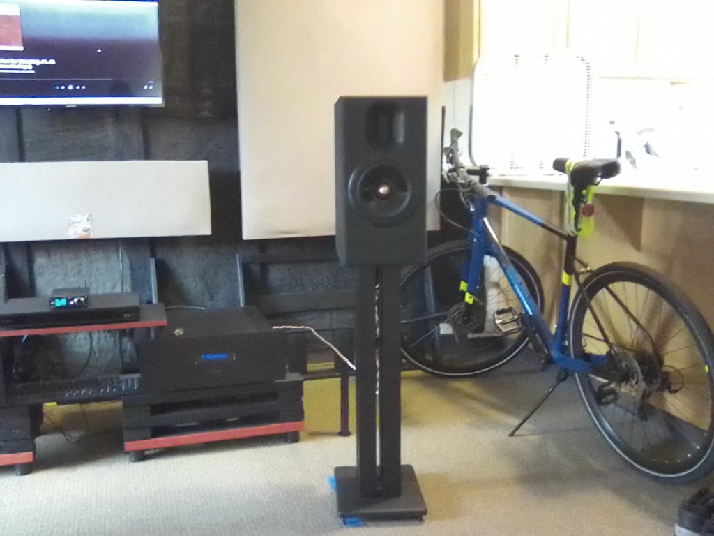

Here's another nice setup...

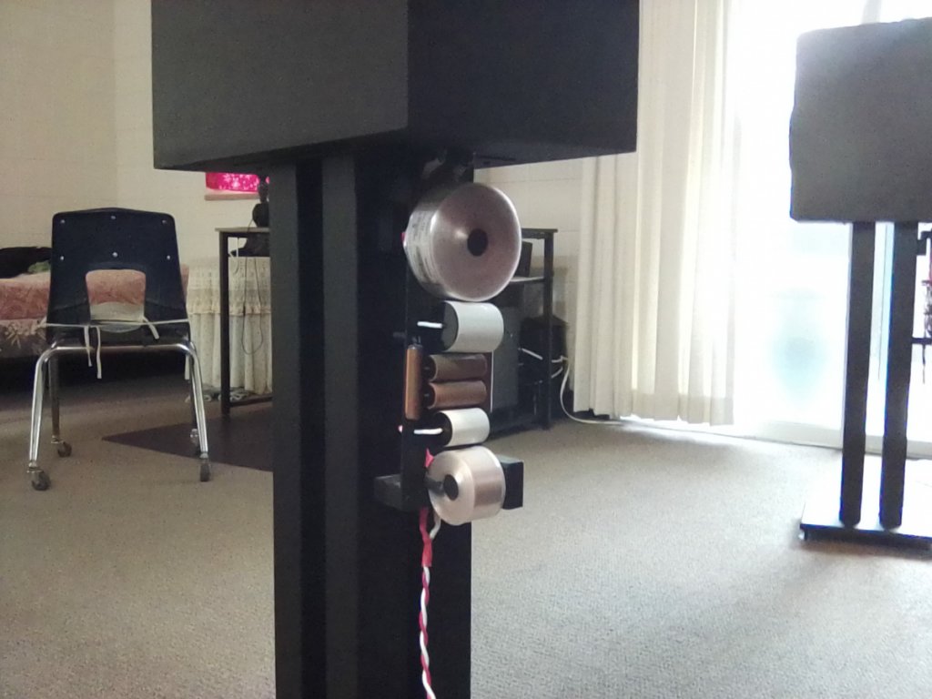

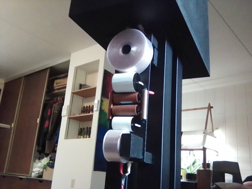

Here is what I did. I can easily change out parts as I want to. And I like the way it looks.

Wayne, that is still one of the cleanest looking external crossovers I've seen.  :thumb:
As for stands Bob, I would suggest something decent and sturdy, fill them to the brim with sand, and place your studios on some Isoacoustics. I found that weighted stands and isolation do make a big difference with these. External crossover mounting is great if you plan to tinker with parts like Wayne or have oil barrel sized caps like Hobbs. Otherwise tuck them inside all safe and secure and call it a day.
Thank You nilt that means a lot to me  :thumb:
The stands are Monolith 28 Inch Speaker Stands filled with Chemsorb GA  General Absorbent 1 Gal. bag. I like like this stuff because it is nontoxic and works well to dampen the stands. I bolted the stands to the studios and run the spikes. I was worried about knocking the speakers off the stands because I have them so far out into the room and the sliding door to the deck is right next to the speaker.
I thought I had seen some pictures of this or something very like it. I agree, very clean! I might put covers over the X-over, just for the cats...
