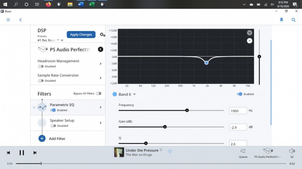

I was reviewing some older posts on DCX2496 crossover settings and I found an interesting comment Brian made concerning mid panel "presence" peak as he called it.  This post by Brian concerns dialing in a room which had limited dampening: https://www.audiocircle.com/index.php?topic=59669.msg530833#msg530833 and the comment of interest, "2.9 dB of cut between 1 and 3kHz (Q=2.6 centered at 1.9 kHz) to tame the ribbon mid panel "presence" peak its designer was so fond of (curse you, Dragoslav!)"
I just dialed in -2.9db at 1.9Hz with a Q of 2.6 into my DSP engine, and need to spend some time with it.
This other comment was of interest, "a 220Hz xover at 24dB lowpass and 12dB highpass, and another proprietary EQ which I use to reduce IM distortion." Anyone know what the "proprietary EQ" Brian used?
Most of my DSP setting deal with room issues, as opposed to making VMPS speakers sound better like the above tweak Brian pointed out.  Any DSP tweaks that you use that are VMPS speaker specific to improve their sound to you?

Really good points on getting good sound. My initial post was an attempt to bring to light an issue Brian mentioned with the neos that one can experiment with as now days many use DSP engines. A few keystrokes for a minor tweak; a picture may better represent. I am still spending time with it. My initial impressions is that it is not quite as forward. Really not sure what I prefer, but I am leaning towards Brian’s recommended correction as more natural.
Still stuck on Brian’s “proprietary EQ”. Great point of how the designer uses stock parts in a crossover is considered proprietary.  However, with the context of using the DCX2496; it may be an unsolved mystery.
