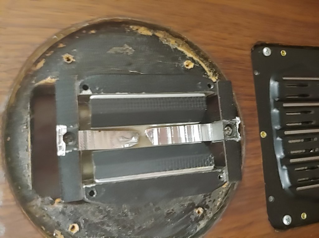

I finally found the time to give this a shot. All went well except there is no volume from the tweeter. After speaking to my Dad about it and testing, we believe is the crossover.

I was able to remove the foam material with a heat gun from the tweeters without issue.
I made a make shift shim out of some thin plexi I have laying around and sanded it to a point.
No damage to the tweeters or the foam material.
Was able to fully preserve them. So they will go back on.
Decided to leave the tweeter in place and not desolder at the time.
The philips screws for the fastening blocks for the ribbon are rather shallow. Had to sand down a philips #1 which worked very well.
It took 3 ribbons, I ordered 6. Used plastic tweezers for handling the ribbons.
The first try I thought I had made a mistake, as the ribbon was ever so slightly touching the right magnet. 1/32 or 1/64 off to the right.
2nd try I paid close attention this time and got the alignment perfect on the fastening block, but same thing. I believe there is some kind of manufacturing tolerance maybe.
3rd try I took that very small measurement into account, so basically placing the ribbon on the fastening block just ever so slight left and got it perfect.
And all back together.

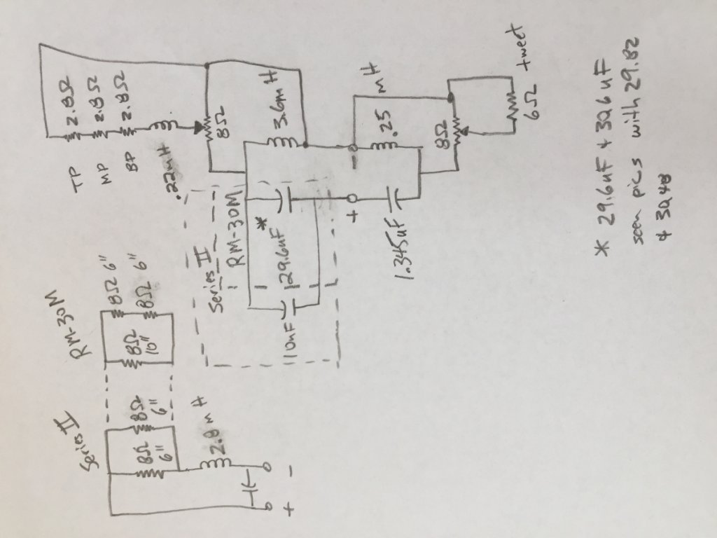

I have not taken the time to make a schematic of the RM-40. One of these days when I get time, I will reverse engineer the circuit and post. I can tell you for the tweeter it is exactly like the RM-30 and RM-V60 with a capacitor in series, then inductor in parallel going to a divider (L-pad) network. For the RM-30 and RM-V60 the component values are the same (1.37uF and .25mH) and RM-40 likely, but I have not verified RM-40 values. Below is the RM-30 schematic and RM-V60 schematic courtesty of Shaukat @shauk786. The schematic I drew for the RM-30 is harder to follow, but it the same as Shaukat's.
Thank you very much! This should come in handy
