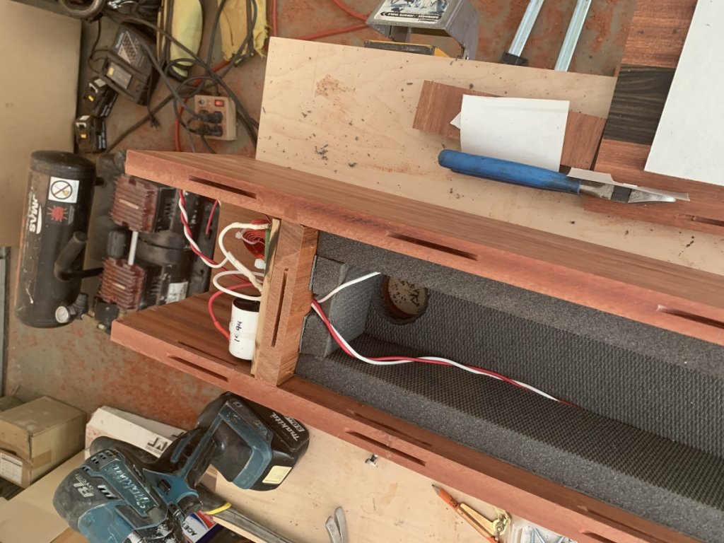

« Reply #12 on: 30 Jun 2020, 04:22 pm »
Wow those look great!  Any chance you could snap a few pics of your crossover? I am mid-build and need a little help with how best to arrange the crossover.

DeShongh
  • Posts: 4
Re: Newbie A/VO build
« Reply #14 on: 1 Jul 2020, 10:43 pm »
Here’s a better pic of the crossover. A lot to squeeze into a small space. I liked the idea of a upward firing midrange/woofer because I heard a pair of OHM speakers, years ago and was amazed how the sound followed me around the room. These are more directional than I remember the OHM’s to be, but I believe less directional than bookshelf speakers would be. Listening to Ahmad Jamal - At the Pershing, I had the experience of the speakers disappearing and the performers sounded as if they were playing from beyond my TV wall and a bit to the left. Boston was plenty loud and the bass was outstanding but VanHalen definitely needs a subwoofer. I still haven’t made a base to attach my floorspikes too, but soon. They’re heavy speakers and not really moving anywhere as they are.
