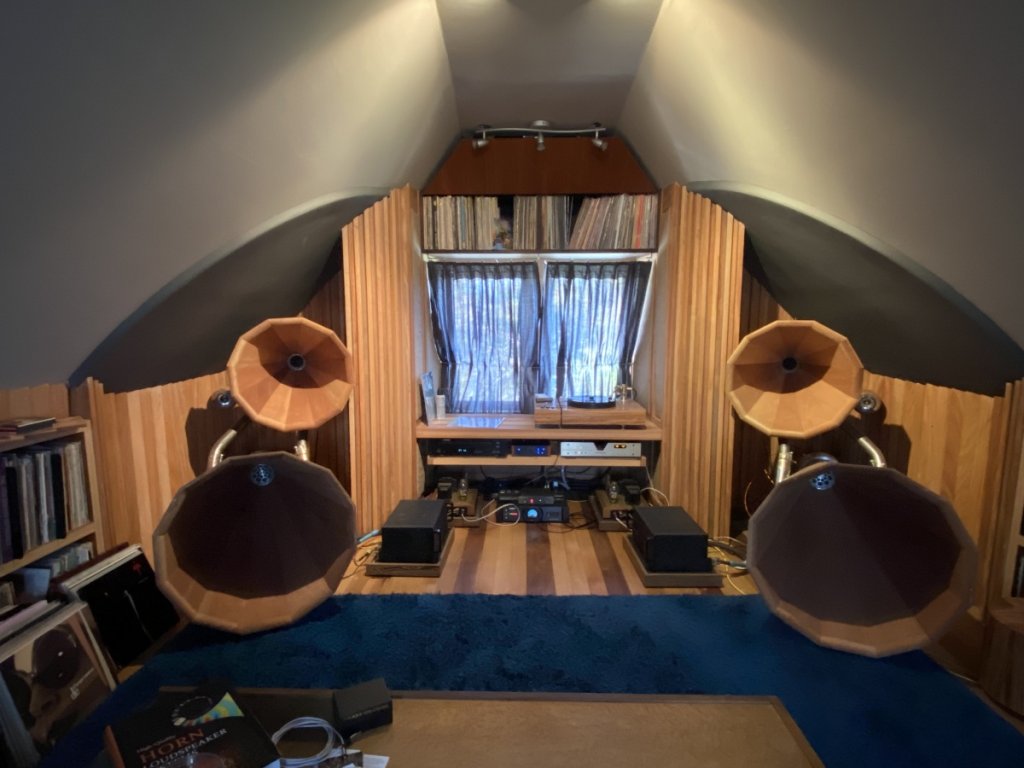

I've been a low power SET amp/high efficiency speaker guy for 20 years now. Done badly, stay away... But done right nothing comes closer to the real thing IMHO.
For me it started in 2000 with the purchase of a pair of early '50s Altec A5s. While certainly not the last word in frequency extension, they were/are wonderful and have a huge, open, relaxed presentation that you could listen to without fatigue all day and night.
I then built my own 3 way system using vintage JBL drivers (D130 in a folded midbass horn, 2440 one custom molded tractrix horns) and Fostex horn tweeters. That system served me well for 15 years.
I'm nearly completed with what should be my last upgrade to Cogent field coil compression drivers for mids and mid bass along with my Fostex tweeters. This system also big built-in folded 30Hz bass horns for the bottom octave (All of that weird wood work behind the speakers is the bass horn mouths)
System sensitivity >110 db 1w/1m
While it can play cleanly at painful levels, I don't usually do that. listening in the lower 80db range it's got incredible transient response and micro detail. The speakers really do not seem to be the source of the sound: I just get a life size stereo image that seems independent of the equipment around the room.

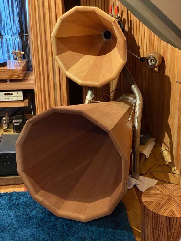

I am working on some Avantgarde-style 1" round horns currently.  Perhaps I should give the Beyma CP380M a try.   :icon_lol:
Jon L
Re: Compression Drivers. Please Share the experience.
« Reply #14 on: 25 May 2020, 09:15 pm »
Finally put together the round horn system with same drivers, and there is quite bit of difference between Seos12 rectangular horns and round horns, which are made out of thick fiberglass and glued to wooden mounts.  Rectangular horns "control" vertical dispersion well, but the round horns do not change sound much when I stand up or sit on the floor, with overall more airy, live sound.  Sounds incredible, actually  :green:
