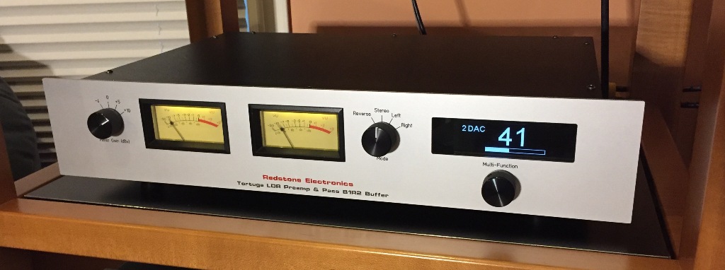

I've finished up a new balanced preamp using the Morten's V25 LDR boards and OLED display (which is GREAT!).  I added buffers and VU meters to the preamp, details here:
[url]https://sites.google.com/view/tortuga-balanced-preamp/home[url]

Mike, that's an amazing job! I followed the full build thread in the link and really like what you did.
I have a question about the addition of the B1 Buffer, though. Why did you add this and what role does it play vs. the existing LDR passive attenuation?
Benny-x
  • Posts: 8
Re: New DIY V25 Balanced preamp project completed
« Reply #7 on: 29 Dec 2019, 08:39 am »
Hi Mike, I was reviewing your build thread again and have 2 questions I hope you can shed some light on.
#1.
I wondered why it looks like you used each LDR board for R+ and L+ then R- and L- on the other one. and if that's not case, maybe they're configured as R+ and L- and R- and L+? Either way, it seems that you have 1 signal from each channel on each board and I hope htat you ca nclarify a little about that.
#2.
Can you explain how the signal wires are coming off the volume pot? How are you not "dirtying the signal" when the pot should only have 1 "output". Not that I have a solid understanding of this, but it looks like you took 2 leads off the same pot, 1 to the LDR boards and 1 to the buffer boards. Is that right? I get that that might be the whole point of the buffer boards, but I'm kind of learning as I'm going here.

@ Benny-x : Tortuga doesn't use pots whatsoever. That's kind of central to Tortuga's existence and success. Traditional wiper pots are generally awful attenuators especially the more they have to attenuate. Volume control is via the LDR's which are controlled by microprocessor. The external knob is just a multi-controller (encoder) for the microprocessor. None of that is in the signal path.
