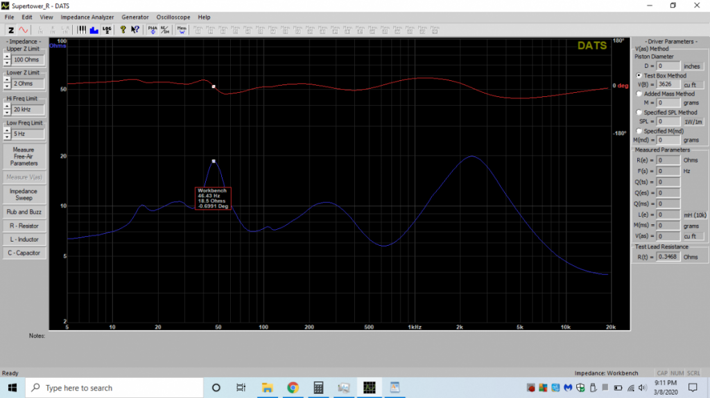

Also I did an impedance sweep using Dayton Audio DATS (shown below, and by the way, what's up with the 20 ohm impedance peak at 2.4K?) .  I do not get the double impedance peak that you should get with a passive radiator setup, not sure what is going on.  The only peak that shows is the woofer impedance peak, there is no "saddle", and no peak from the passive.  I tried different mass loads on the passive without much change.

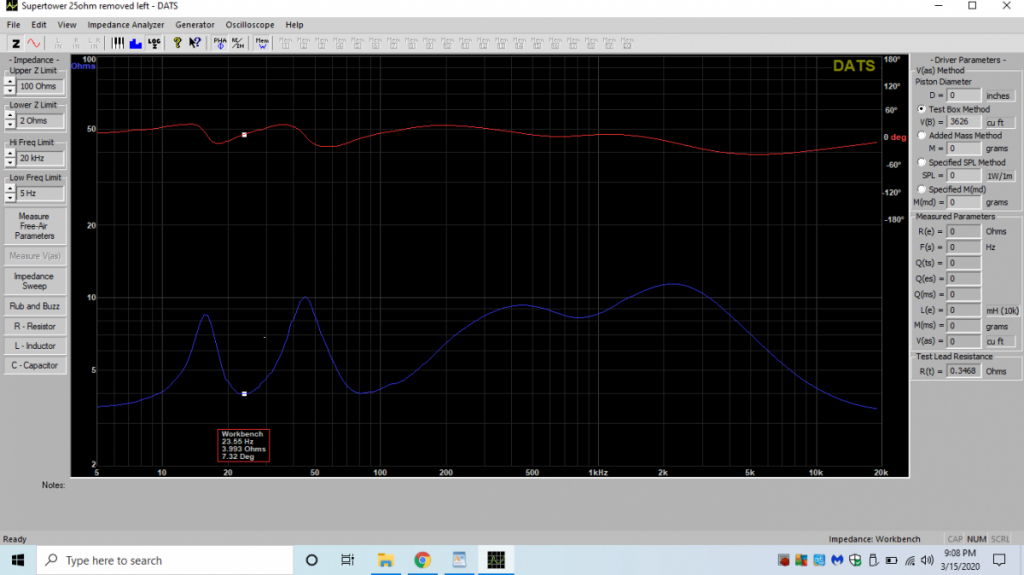

I did more impedance measurements but first some background.  The original parallel twelve inch and fifteen inch woofer had a twenty-five ohm ten watt resister in series with the twelve inch.  When I updated the twelve inch with the Misc woofer and the fifteen inch with the Goldwood I kept the original configuration with the twenty-five ohm resistor in series to the Misco woofer.
I measured the impedance with the resistor (original trace above) and without the resistor (below).  You can see without the resistor the impedance looks much more as expected. I removed the resistor. The bass is back!  I have not heard low bass from these speakers until now and the overall balance is much better.

Well, yes and no.   With a series crossover changing any component affects the performance of all of the others.  For the original components (including the original mids) the 25 ohm was required, the inductor was 1.0mH, and the capacitor was 48uF.  I forgot to mention when I changed the woofers I also bought new mids from Brian.  When I changed to the newer drivers Brian had me change the inductor to 2.8mH and the capacitor to 54uF.  I don't remember if he told me to remove the 25 ohm or keep it, but I ended up keeping it.  So when you look at it, I bought from Brian a whole new series crossover section of the Supertower, drivers and crossover components (two woofers, two mids, one inductor and one capacitor for each cabinet). It turns out changing the impedance of the Misco driver by putting the 25 ohm in series with it, and having that impedance in parallel with the Goldwood fifteen changed the impedance of the woofer section of the series crossover enough to muck up the whole network and kill the low bass, and also change the impedance of the midrange, if you compare the two traces.  Removing the resistor brought everything to where it should be, including the midrange impedance.
