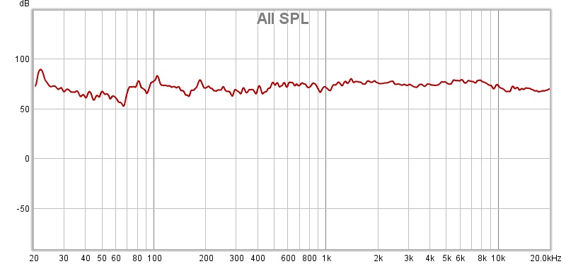

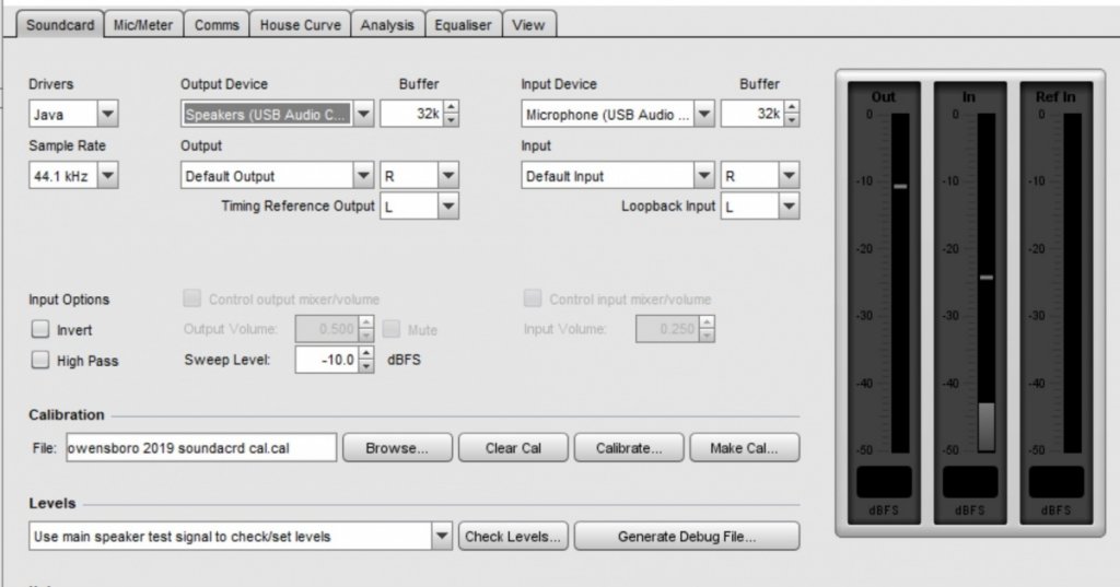

I can't find any photos I should have of previous set-ups so I'm wading into the newer version of REW on Windows 10 on my newer computer. I can't decipher what to set the Preferences page to for the input and output devices. There is no way as I move the mic around the room that is measures flat and essentially identical so I'm probably not measuring the room at all with my set-up! :duh:
I am using the cal file for the EMM mic and made a new cal file for the soundcard.
So here is a run with the mic in a random location near my seat. Zero room treatments and no carpeting.
In the Preferences window you can select which input and which output device. This is confusing to me and gets entangled when you set your Sound in Control Panel. That's another question I have.
Not sure how to set the Sound on the computer as well wrt the speakers and microphone.

I think the confusing part for me is the input and output settings in the Preferences. I've found housekeeping items like having the 48 khz checked if you used 48khz when making the cal files, etc. type of items. I feel like I get into a loop if I select the input and output to both be the soundcard versus default devices?!

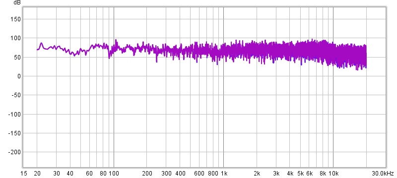

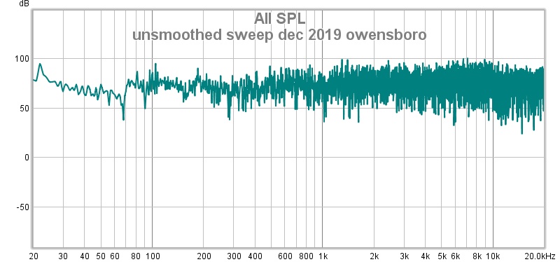

Well, this is what I am getting. I know that the external mic is accepting signal. I am skeptical my untreated room actually looks like this.
How would I best display the reverb that is happening with all the surfaces untreated right now?
1/24th sweep
no smoothing sweep

change your scaling and you'll get what you think you would see = room needs A LOT of work.   ;)
X axis - 15 - 200Hz
Y axis - 5dB increments

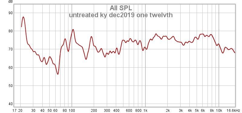

There's only a zoom/magnifier function these days. Here's what an untreated room looks like with that scale corrected.
I can fix this! :o
I can fix this! :o
No. There’s not just a zoom/magnifier function. REW’s updates didn’t make the product worse it is much better today than when you previously used it! On the right upper hand corner, there should be something that let’s you set the graph axis limits. I use it periodically. Set it like Jason suggests and it will be eminently clear how room modes are wrecking havoc in the <300Hz region as they always do. And it’s recommended to eliminate the smoothing so you can see the details.
