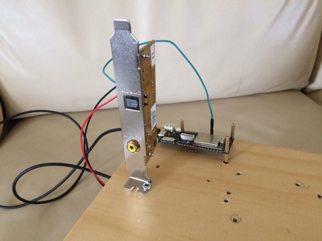

I got lazy and bought a used S/PDIF card designed for a PC motherboard with a S/PDIF header.  Ran +5 volts and ground from my power supply and the raw signal from the ESP32, and now have both toslink and coaxial outputs.
It's now in a wood box feeding the DAC ahead of my headphone amp.  A real cheap and cheerful squeezebox steamer.
