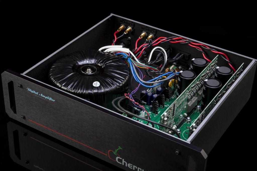

The Cherry Amplifier® brand (manufactured by Digital Amp Co) was first known for its “big Cherry” amplifiers, which are now called Classic Cherry.  These are still built today, more than a decade later!  They are based on proprietary Class-D amplification circuits that are optimized for world class sound quality.
Classic Cherry amps drive speakers with authority!  They are high power (600-900Wpc into 4Ω), low noise (116dB SNR and up), low distortion (<0.009%), high bandwidth (>50kHz) amplifiers that have been called “the most tube sounding solid state”.  However, with Cherry Amplifiers, you don’t suffer from tube amp issues like rolled off frequency response, high noise, high distortion, low damping factor, anemic power output, wasteful inefficiency, and never-ending tube replacement.  So you’re left with authoritative power and silky smoothness, problem free.
The Classic Cherry utilizes an internal linear power supply based on a large toroidal transformer (750W to 1800W) and comes in Stereo and MONO versions.  The outputs are single ended and run from bi-polar power supply rails.  Weight ranges from 30 to 40 pounds.  Inputs are true balanced and single ended removable ground lift RCA input adapters are included.
Maraschino series of amplifiers was released in 2013 and received much acclaim.  The Maraschino uses a newer circuit design able to reach 100kHz bandwidth with end-to-end DC coupling for response down to 0Hz and no bass phase shift.  As with the Classic Cherry, measurable audio performance is spectacular. Distortion is even lower than the Classic Cherry at 0.002%. Output impedance is extremely low (<0.04Ω) for the entire audio band with a damping factor of 500 at 1kHz.  The Maraschino amps also offers auto-sleep, so they can be powered 24/7 and wake up as soon as the source becomes active.
We use a more refined approach to the control loop of the amplifier by allowing it to remain controlled way past the audio band, yielding minimal phase shift into the ultrasonic range.  The ground of the amplifier is locked to the audio source (preamp or DAC) ground to eliminate hum and ground noise.  The result?  Customers and professional reviewers have praised the Maraschino for sonics that go way beyond today's cookie-cutter "me-too" module based amplifiers.  You’d be surprised how many amplifier manufacturers don’t even design circuits these days.
Many customers have chosen to keep their existing speakers after hearing what Maraschino amplifiers can do for their system’s sound quality.  They enjoy the quieter noise floor, better bass, lower distortion, higher bandwidth, and the amazing control regardless of the music playing over a huge volume range.  The sound Maraschino amplifiers produce is often referred to as liquid and juicy.
The Maraschino Amplifier product line grew to include Desktop Maraschino, a new novel shape for monoblock amplifiers, In-Line Maraschino, amplifiers so light, you can hang them from your speakers, yet so powerful, they can deliver up to 1000W into 1.8Ω, and Stereo Maraschino, an integrated amp with single-ended front and true balanced back inputs, plus volume control.  All of these are powered by external, upgradable power supplies.  Max voltage is 60V (KING versions), and power output into 4Ω is 400Wpc.  Lower cost 48V versions supply up to 250Wpc.

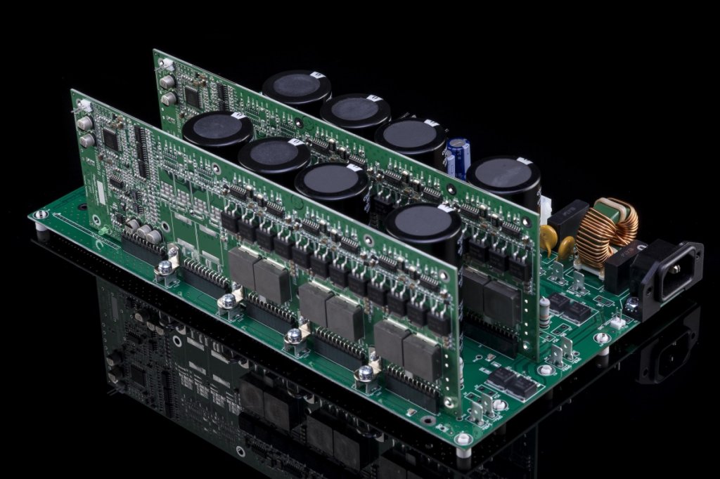

So what if you want that juicy Maraschino sound with more power?  Through years of R&D, we were able to build a new, high-voltage version of the Maraschino, the MEGAschino.  This was no easy feat.  With this new “MEGA” amp design, released in 2017, we are able to provide all the benefits of the Maraschino design with the voltage and current carrying capability of the Classic Cherry, and MORE!  With even lower output impedance and wider pulse differentials, you can get approximately 10% more power into your speakers from the same power supply compared to Classic Cherry.
The Cherry MEGAschino (referred to as simply “MEGA”) is not just a higher power version of a Maraschino amplifier.  It is based on Maraschino technology, and does run at significantly higher voltage, but other advances have been made in order to facilitate this next level of refinement.
The MEGA uses 12 output devices per channel, and the Maraschino uses 4.  In a way, this is like comparing a V4 engine to a V12 engine.  We developed a superior method for removing spurs in the passband at low levels (as seen on an FFT), thus allowing an even lower "spike free" noise floor while allowing power output to exceed 1000Wpc.  The overall topology is similar to Classic Cherry in that both use the same 16 gauge cold rolled steel enclosures and large toroidal transformers.
Here’s how the MEGA was optimized for sound quality.... We start with amazing bench specs, like 128+dB SNR and 0.0008% THD+N, then we tweak for sound AFTER that, and we wind up with 120dB SNR and 0.001% THD+N, still pretty amazing on the bench, but even better into your ears.
The huge headroom and DC coupling deliver stunning bass with "hit you in the chest" transients.  This amp can deliver current!  With a strong toroidal transformer based power supply and ultra low output impedance into the upper registers, instruments and voices are rendered with unrivaled clarity on even power hungry speakers.  It's like a bottomless pit of super clean power!  Plus, the highs have a silkiness that allows the proper fade to cymbals, and super fast transients are no longer inhibited.  The most surprising thing of all is the performance at low volumes.  You don't need to crank it up to get refined focus and locked-in imaging.  The MEGA is meant to produce better sound on your existing speakers.
