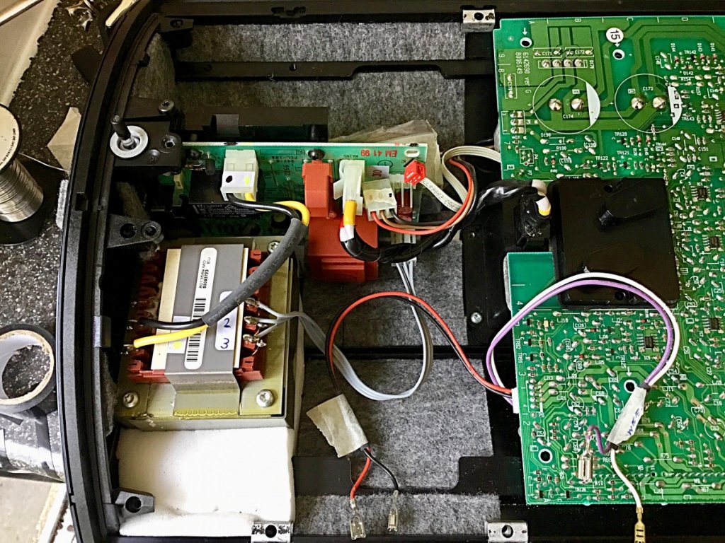

The unmodified circuit boards are shown in the photos...

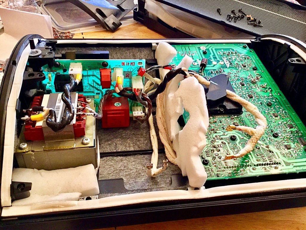

Ok now I’m going to show the circuit board modifications done. I swapped out all the junk wire for Neotech and Jupiter 6 nines copper, and Kimber.
OSIB16
  • Posts: 390
Re: B&O BEOLAB 4000 ACTIVE SPEAKER PROJECT
« Reply #6 on: 12 Jul 2019, 10:14 pm »
I Installed the following wires myself...
NEOTECH 12AWG PVC STRANDED COPPER (Power Input + Transformer Input).
KIMBER 19AWG VARISTRAND COPPER (Power Jumpers).
NEOTECH 16AWG SOLID CORE BARE COPPER (Bass Midrange drivers).
JUPITER 23AWG SOLID CORE 6N BARE COPPER (Tweeters).
(((((ALL BARE COPPER WIRE IS TREATED WITH DEOXIT GOLD & THEN COVERED IN PURE COTTON SLEEVE)))))

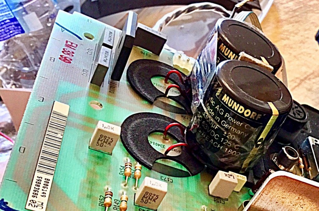

I fitted the 2 large Mundorf AG capacitors onto the board myself. They are slightly taller than the old Samwha’s  and had to be slightly offset to fit into the cramped speaker cabinet. I extended the legs with OCC Copper 18AWG magnet wire...

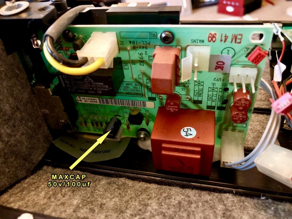

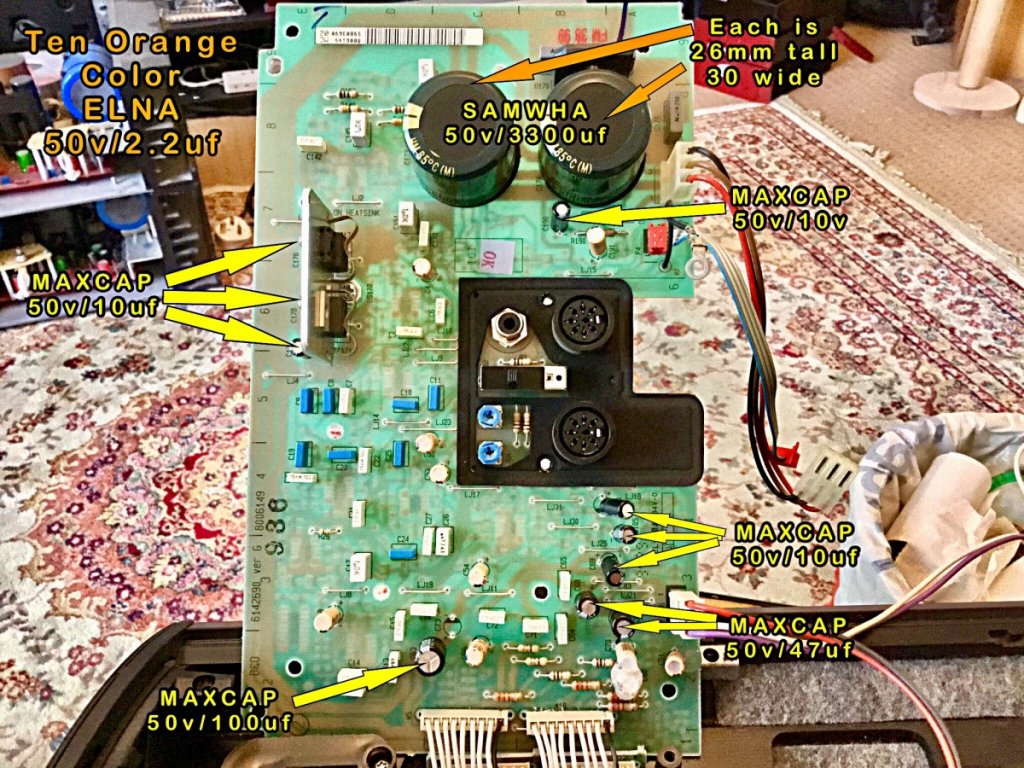

My local hifi repair guy installed all the Elna Silmic II electrolytic capacitors and ensured that the speakers were up and running...
