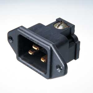

As for the IEC question, I should have phrased it better.  Can the IEC in the back of the amp be swapped out for the rectangular 20amp receptacle which is a more stable physical/mechanical connection (or is it part of the breaker/switch assembly) ?

What's your first name?
We had to look into this and came to the conclusion that it's possible, but would be a one-up custom piece.  Thanks again.
