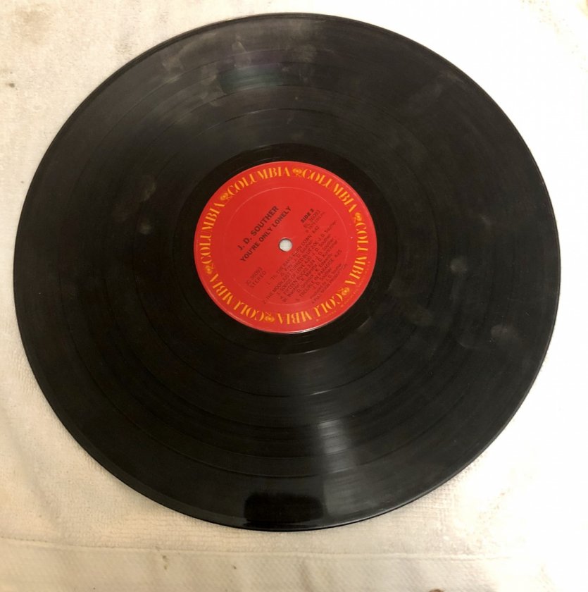

I rinse in cold water then use a micro pore soft sponge with ivory pure, rinse and immediately dry with soft cloth’s.  It can take a cleaning playing and repeat cleaning to debris deep grime and dirt.  Well worth it when you can find gems for $1.00 at thrifts.

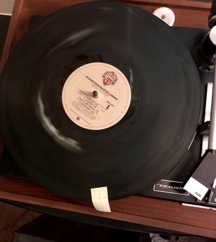

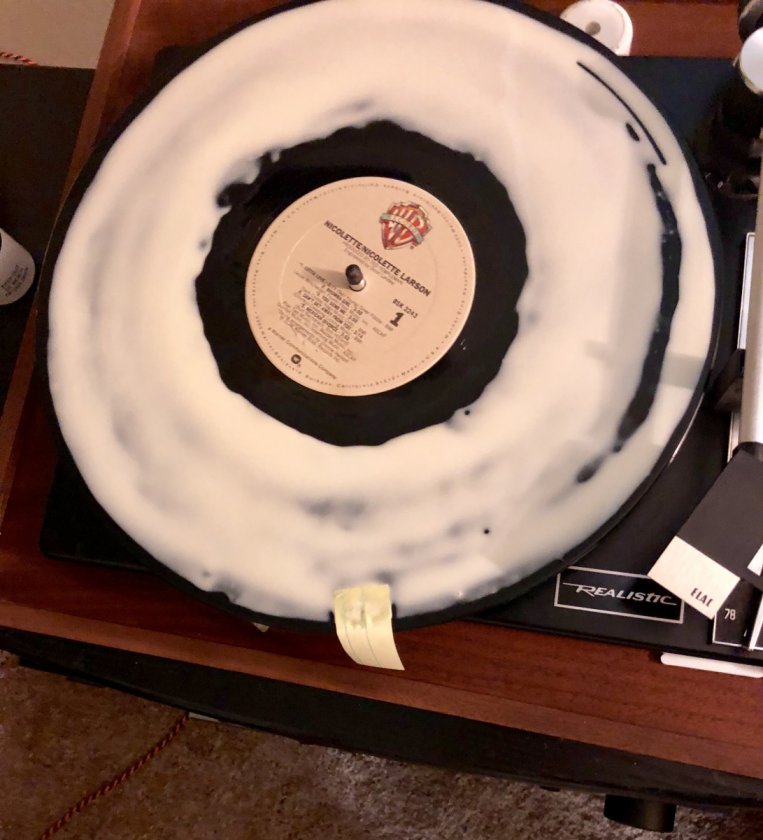

All that said, I’m going old school and using titebond.  Once it dries clear it is ready to peel off with all the nasties.  Takes more time, the results are outstanding.  I use a small piece of paper to help with the peeling process, usually comes off in one piece from memory.  The key is waiting till it’s completely dry, about 12 hours.

Gel school glue is easier to remove than other types of glue in my experience and works just as well. Also, as it's water soluble, a post glue cleaning removes any worries that a left over bit of glue could wreck havoc with a your stylus. To make removal easier after drying, I leave a little paper tab the size of a ph test strip in the edge of the glue. While I use vacuum cleaning as the cleaning method of choice, both steam and glue are worthwhile alternatives for the odd stubborn cleaning problem. Definitely want to get an ultrasonic cleaner one day.

You are right about the type of glue, I’ve been using titebond and it tends to peel in pieces.  That said, the results are very impressive.  A couple of lp’s that I have done are now like new, a couple still have skips that may be incurable. Will put them aside until my spin cleaner arrives.  Will be getting some Elmer’s😏
