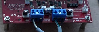

Hi guys, recently doing some experiments, and cut off some wires, but dunno how to put back, I would like to configure to use RCA single ended input only, but I'm not able to figure how to, here's the pic, it seem there is no jumper to set RCA or Balanced XLR? Hmm, it takes me sometimes but still cannot figure out how the RCA/Balanced XLR switch works, there are 4 wires initially from the switch, white yellow white yellow, the connections very complicated even I check back my pictures, do I need to install jumper ports on nearby the bridge port?
Can give me clear details how to use RCA input only? For max gain, I just need to desolder left and right gain jumper parts, then put a jumper right?
Please take a look on the picture. It shows RCA Input connected with Jumper in place for Full Gain.
