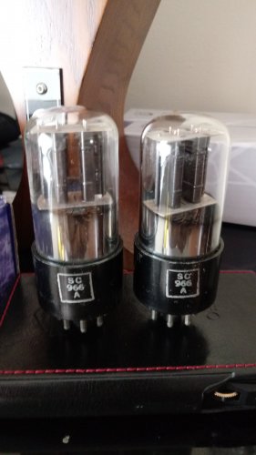

can you identify these for me ?  the claim is Sylvania VT-231 dated 1966 ?

Sorry I cant, but date is SET1966, plate looks similar to this TungSol tall boy, but not the mica spacers:
Sure its not a Russian, it may be the brand you mentioned.
This thread may help: https://www.head-fi.org/threads/the-6sn7-identification-guide.209782/
A_shah
Re: Can you help me find some info on this tube, 6H8C
« Reply #10 on: 30 May 2018, 03:12 am »
 Thanks ! :thumb:
