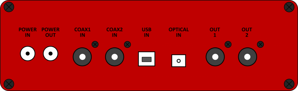

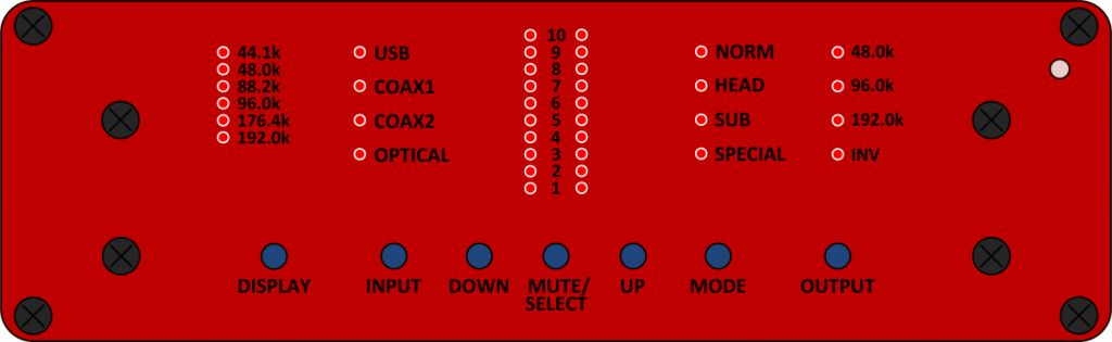

Update: We are working hard on the design, and plan for production early 2020.
New panels! -- see note below
NOTE: We received much feedback about the design, and we're changing the nature of the product.  Stay tuned for updates as they are available!
