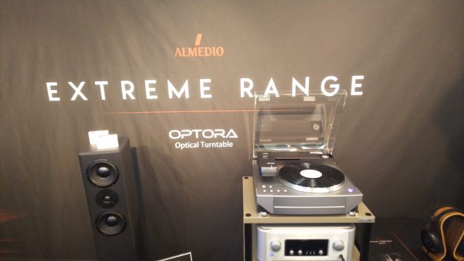

Introduced at High End Munich 2018, scheduled to be shown in North America at RMAF in October.

In this video https://www.analogplanet.com/content/walk-halls-high-end-munich-2018-analogplanet-editor-michael-fremer about 5 minutes in Michael Fremer encounters the OPTORA. The pictured unit is a non-working prototype so any comments on the sound are in the future (assuming it gets past vaporware stage and into production). Fremer interviews an employee of Almedio and through the language barrier of New York English vs Japanese English one learns the following:
  • LP is read using no physical contact via laser.
  • Five laser beams are used. One to measure distance above disk. Two to obtain focus on L & R groove walls. Two to read L & R groove walls.
  • Almedio is in the laser disk drive (CD, CDROM, BR, etc) business and is leveraging that technology into the OPTORA.
  • System is fully analog with both line level and phono level outputs.
  • Asked about how the player reacts to dust and dirt in groove a good answer was not forthcoming.
Below I will add some links to info about the original laser LP turntable the ELP. In the TAS review like others of the time the issue of noise from the fact there is no rock pushing aside dirt looms large. Should they make it to market it will be interesting to see if the reboot of this technology when ultrasonic LP cleaners are becoming so popular makes a difference.
