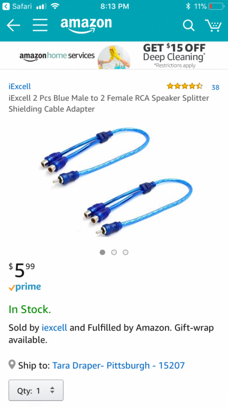

I tried this yesterday with no luck . I could hear something coming out of my 8 inch sub but it was barely audible turned up all the way. The 12 inch Sounded fine I believe.
bought this:
Amp is Onkyo tx8050
Not sure what I’m doing wrong .
Thanks for any help!

You may need to go into the Set Up menu on the ONKYO and INCREASE the signal output to the SUB.

That's pretty inexpensive price. $1 per connector, so there's no QA, you might want to verify that the cables actually work by swapping the outputs to the subs.  If the outputs of a splitter have different signal levels then the splitter is defective. You can play a 40 Hz sine wave to measure the signal voltages of the outputs to verify.
If the two subs have very different input sensitivity you would have to adjust the subs' volume levels to compensate.

Thanks gentlemen!! I think the splitter is fine as the one 12 inch sub was fine , and the wire itself looks to be of great quality actually .
Weird , the 8 inch sub was barely audible.
I am really horrible at AV stuff .  :duh:

interesting. I have a similar set up and levels do need to be matched depending upon the sub sensitivity etc.
However, I'd be nervous using connectors that cheap and cheap looking. I think I draw the line at around $8 per connector. But to each their own...

Try hooking up one sub at a time to the splitter and try both sides. Let us know what you find out from that.
In other words do the subs work hooked up one at a time using the splitter?
