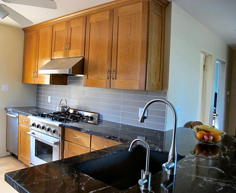

Putting a microprocessor controlled LCD screen on a stove seems like the worst idea ever. Our parent's stove's lasted for 50 years, I can't imagine a new stove lasting that long. So I picked an "analog" stove for my kitchen remodel. True commercial ranges were out of my budget but I discovered NXR through a local dealer and after 4 years I am 100% satisfied. When I went to order the stove the sales person was rude and unhelpful so I bought online from AJ Madison for $2050 (don't forget to order the continuous center grate) with free delivery and saved on sales tax too.
Consumer Reports: A $2,000 pro-style range beats some bigger names in our tests
http://www.consumerreports.org/cro/news/2013/07/a-2-000-pro-style-range-beats-some-bigger-names-in-our-tests/index.htm
I disagree with CR reporting "it didn't provide fast cooktop heat, and baking and broiling were so-so", in my opinion the cooktop heat and baking are excellent (I don't broil).
My simple kitchen includes a real quiet 18" Bosch dishwasher (far left), black Blanco Silgranite sink and KWC faucet.
Commercial style ranges put out a lot of heat so a dual squirrel cage hood is a must, the Ancona is affordable and quiet, get a hood in the $550 price range so it has adequate CFM.
Plan ahead if you decide to go this route, you will need to install a new 3/4" gas line for all commercial style ranges.
