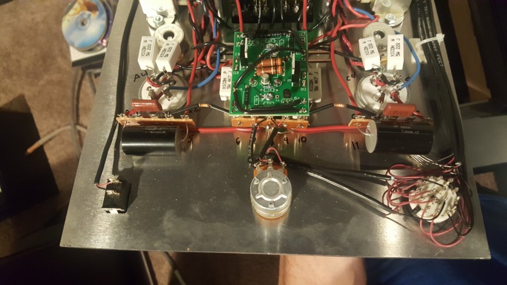

Here is a photo of my stereomour. At this time, I need to get more details.
Ben

Assuming your Stereomour is using a 0.1uF interstage coupler followed by a 249K load resistor, you would need a 3300pF cap.  No Miflexs are this small.  This is actually a very nice cap: http://www.soniccraft.com/product_info.php/rte-3300-pf-600vdc-p-322  I'd recommend some level of matching.  Now, if you have a 3.3uF on a 4K primary on the parafeed, simply replace the 3.3uF with: http://www.soniccraft.com/product_info.php/miflex-kpcu-022uf-600vdc-copper-foil-polypaper-in-oil-p-5290
It might be helpful to post pics of the guts of your amps so Jeff and others can advise you on which caps will (or won't) physically fit.
A pic is better than nothing I suppose, but nothing beats a schematic.  As for it will, or will not, fit...  You need to take the dimensions, and cut out a piece of card stock or cardboard.  Use it to check for fitment  :wink:
