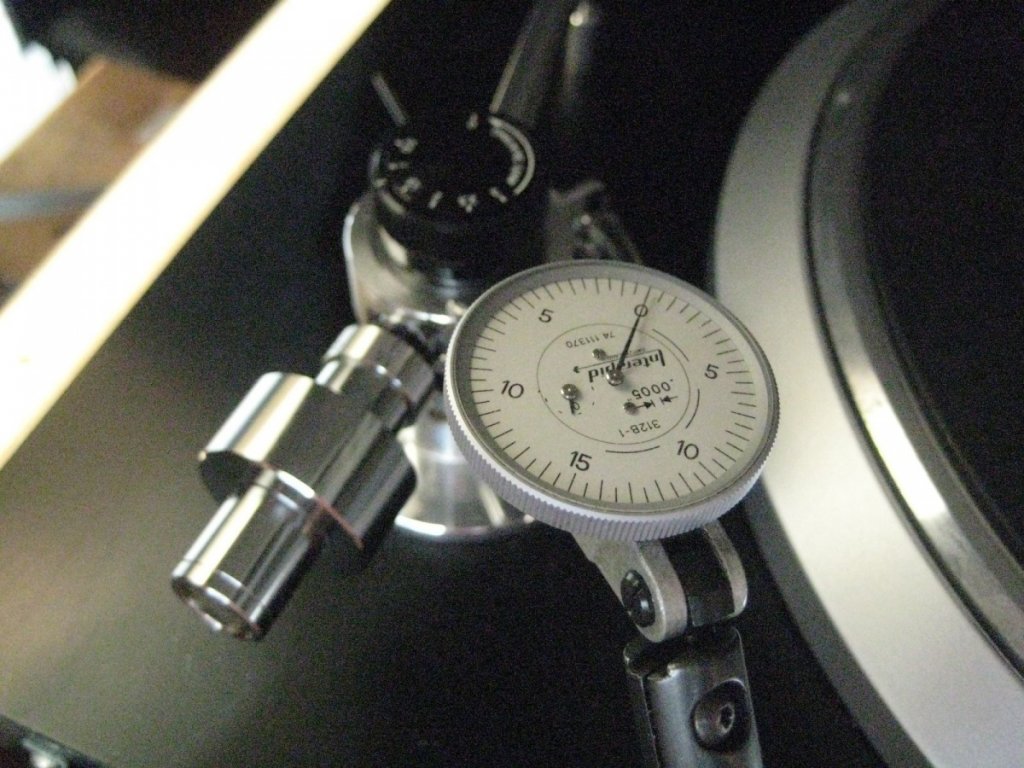

I’m very anal about setting up my TT. As a retired machinist I even put my Interapid test indicator back to work as an accurate why to help
me adjust VTA height(s) and I also use my precision gage blocks to help in getting the arm level as a stating point.
I do Azimuth by ear mostly, as well as anti-skating.

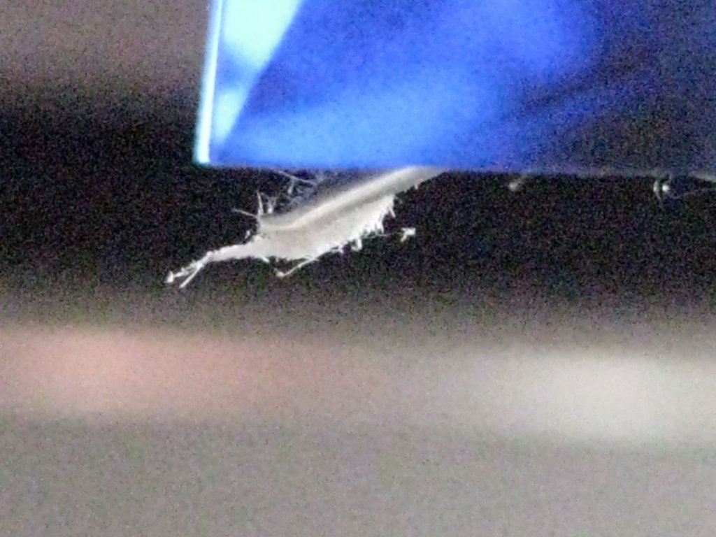

I’ve had a lot of white fuzz buildup on my stylus(s) lately causing distortion/mistracking.
Is it the DIY record cleaning solution or something else?  I don’t know at this time.

I don't know what is causing this white fuzz buildup but it is a real PITA.
bacobits1
Re: Ssssibilance / Mistracking
« Reply #12 on: 14 Jan 2018, 03:22 am »
Never seen that much fuzzzzz. Something is up with that  cleaning fluid.

« Reply #14 on: 14 Jan 2018, 04:03 am »
Ortofon blue?
 I know. I've been trying to pin point what's causing it, but know definitive answer so far.
I did read somewhere recently, if I remember correctly, that a failing stylus may cut into the groove walls causing white fuzz.
Why it would be white rather then black like the vinyl color is beyond me.
I'll look for that info and post it asap.
