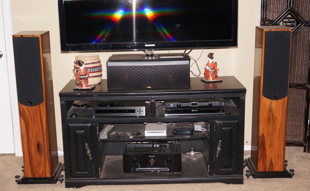

The N1X is also an excellent stand mounter monitor. However, if you want enough bass extension to not miss a sub for music, seriously consider the N3s. While these are floor standers they don't take up any more room than monitors on stands.
I have built N1Xs with upgraded crossovers and X-LS Encores with their crossovers upgraded to the same level as the N1Xs. While these are both excellent monitors, they are -3dB at 55Hz. The N3s are -3dB at 40Hz. With room gain the N3s can dig a lot lower. Mine are solid down to the low 30s.
Again, don't dismiss them just because they are floor standers. If you are going to put monitors on stands, the N3s won't take up any more floor space.
