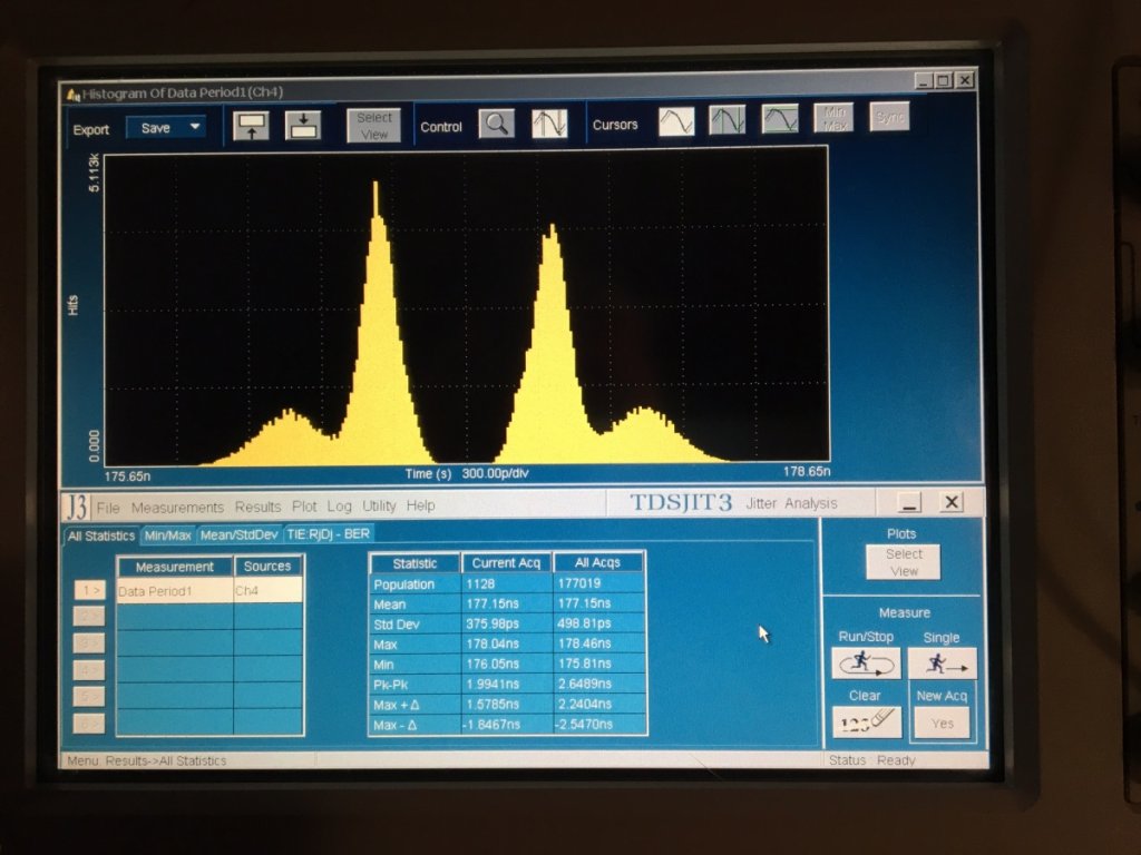

I love my OPPO, but I strictly use it for Blu-ray movies.  It's an older one with XLR outputs, but plays Blue-rays well.  I always wondered if I should bother modding it.  I recently modded my SS processor and this has made movies much more enjoyable.
Anyway, here are the Jitter measurements playing the same track that I always use:
OPPO output jitter with PCM 44.1 track:
Around 800psec of jitter for OPPO alone.

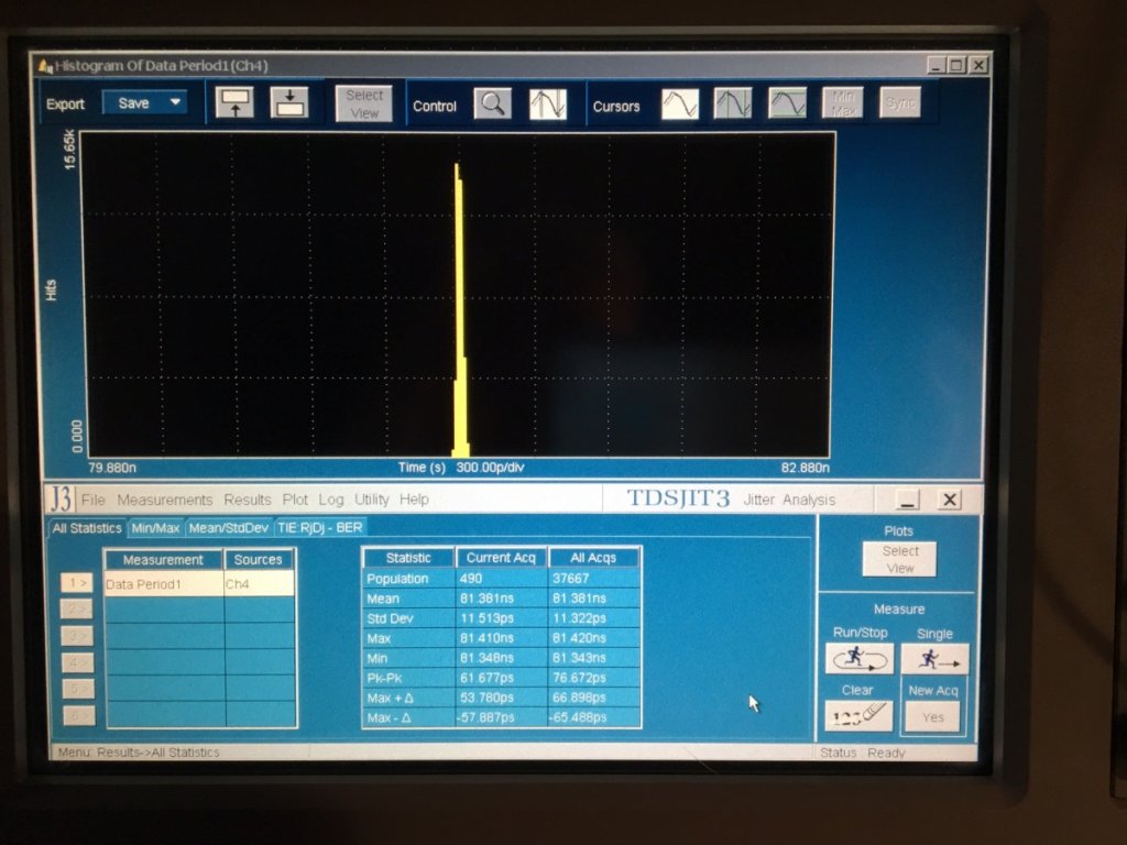

Here is the same signal jitter, reclocked and upsampled to 24/96 with the Synchro-Mesh:
Around 8psec of jitter for OPPO reclocked with Synchro-Mesh.  This is 1/100 of the original jitter.
