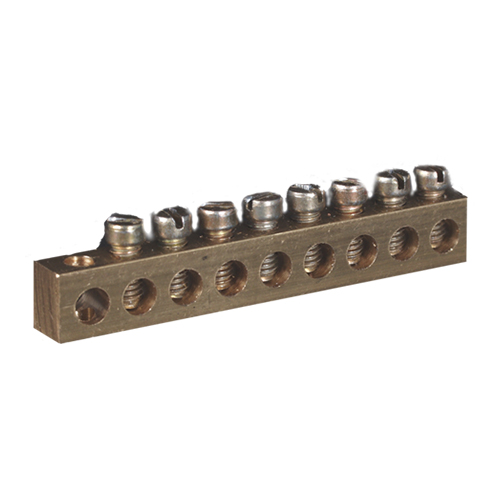

I need AC's help finding a part similar to the photo.
I’ve looked and looked even called Mouser for help, no luck.
It’s just a small copper bar with side holes for 14awg wire and #6 or #8 screws.
Thanks for any help.

What you are looking for is called a copper neutral buss bar. Here is a link to one on Amazon
https://www.amazon.com/dp/B00NVDIQ6S?psc=1
A search using this term will also bring it up on ebay. Also The Mouse as well as DigiKey may have them if you ask for this item.

They are used in AC power, circuit breaker boxes (panel boards).
The electrical department in a big-box hardware store will have them.
