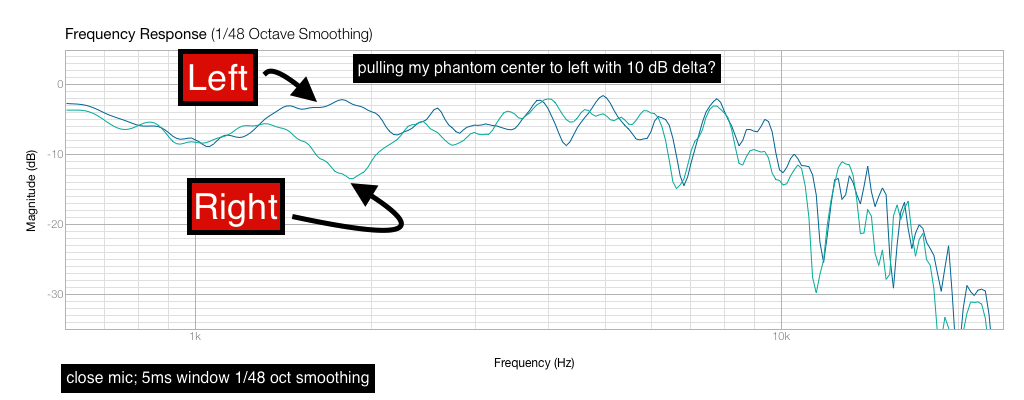

Hi folks. I am still trying to trace down a mismatch between my left and right super V HF speaker. Does anyone know where replacement diaphragms for the HF driver can be purchased? I have about a 10 dB difference between the left and right speaker centered at 1.8 kHz that follows the driver. My last shot here is to replace the diaphragm. I don't believe it to be the amp, room or crossover.

FYI, this is what I am measuring.
I've tried reversing the amp channels (left and right speaker cable swap to see if it is a tube or amp channel). I've tried moving the HF driver from the left P.Audio driver to the right -- the dip follows the driver.
And I've windowed out the room (I'm only using a 5 ms window with the mic inches from the front of the speaker). It's not a polarity problem in the XO (would have not followed the HF driver). I definitely think that this 10 dB gap centered at 1.8 kHz is pulling my phantom center to the left.

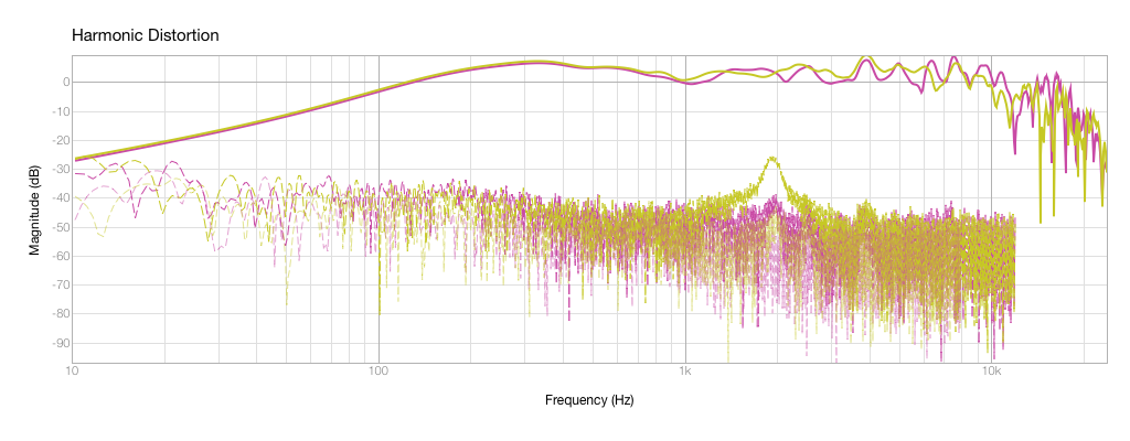

For grins I took out the MiniDSP to try and correct the difference. Applied a + 9 dB boost @ 1.9 kHz Q 2.6 to try and balance out the two channels. You can see the deleterious effects of doing that in the harmonic distortion response. Imaging is better but worse all around and adding that much EQ is killing my max SPL, as you might expect.
Going to put everything back the way is was and cross my fingers that the replacement diaphragms do the trick, with no DSP or other processing needed.

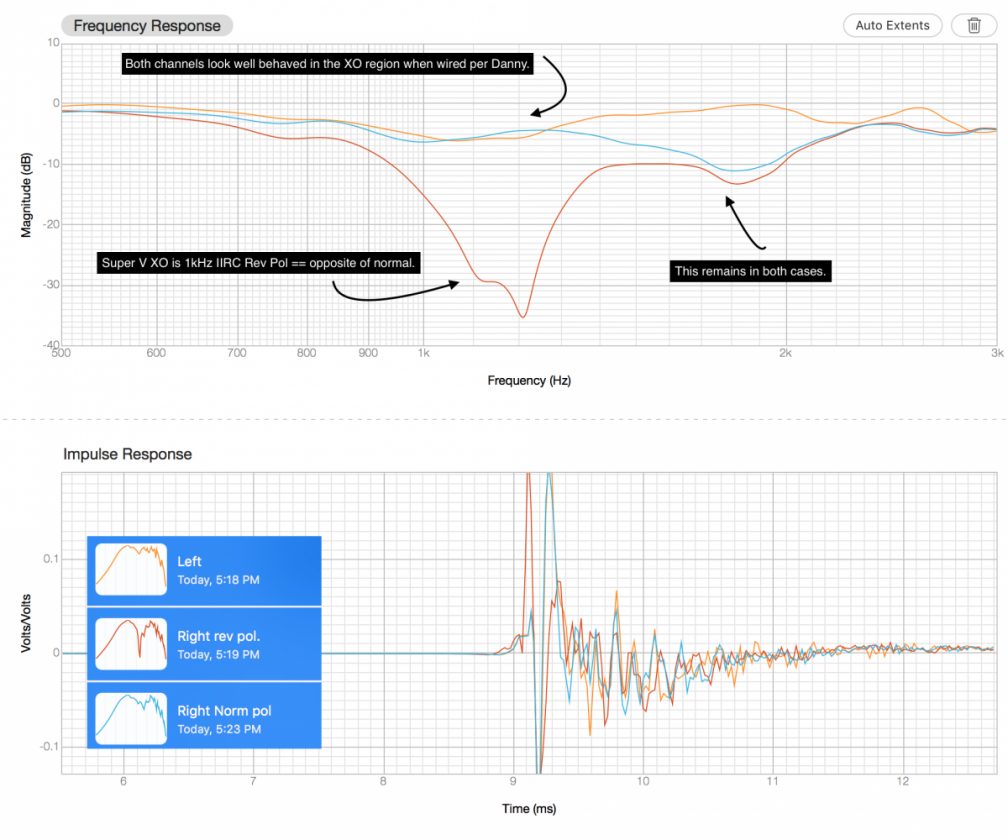

I'd be surprised if the driver is the issue seeing the very normal frequency response all the way up top. Have you tried reversing polarity on the tweeter just to see if that dip flattens out? It almost seems like one of those drivers is wired up with reverse polarity, as that dip is right around what I would guess is the crossover frequency.
danvprod
Re: Replacement Diaphragm for P.Audio BM12CX38?
« Reply #8 on: 23 Jul 2017, 09:50 pm »
Thanks for the thoughts on the polarity, @drewm. IIRC, the XO point of the V is 1 kHz. My measurements would seem to indicate that the XO is well behaved and drops considerably when the polarity is reversed from how they should be wired up (white cable to red terminal; red cable to black terminal).

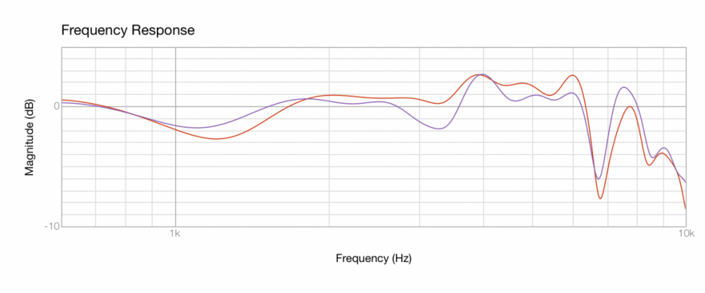

New diaphragms came today from Loudspeakers Plus. Ordered on Sunday and they are here on Wednesday. I love them. Pretty easy job to replace the (although slightly stressful).
Quick measurements are much more promising.  :D
I am very happy about this. The red trace is the right speaker, which had the 10 dB dip at 1.8 kHz. That is gone. I'm happy with the tweeters being within a dB between 1kHz and 10kHz.
Thanks everyone for the help.
