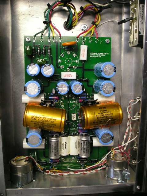

Here is a shot of the latest Cornet I have built.
It uses Jensen Copper Foil, Silver Lead out, Paper in Oil capacitors in the signal path. RIAA resistors are Riken-Ohm. PS Bypass caps are Multi-Cap.
It has the Jensen JT-44-K moving coil transformers built into it.
I used the constant current source.
The transformer is the 370BX.
Tubes are Sovtek 12AX7LPS, CBS-HYTRON JHY 5814WA, and SYLVANIA JAN CHS 5Y3WGTA

I don't want to put words into Jim's mouth, but he did hear my Cornet and did say that it sounded better than the typical breed.  Aside from doing all the standard things (Sovtek LPS, Holco resistors, AudioCap Theta coupling caps,  CCS, etc) I used massive, low ESR Nichicon NT caps in the power supply along along with an ASC oil cap.  This unit sounds great and has very good bass authority.  I also use Jensen step-up xformers but have them mounted externally in a well-shielded environment.  Cheers, mac.
