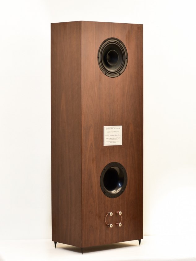

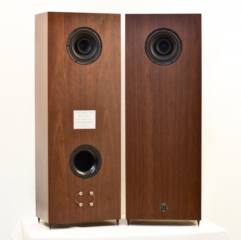

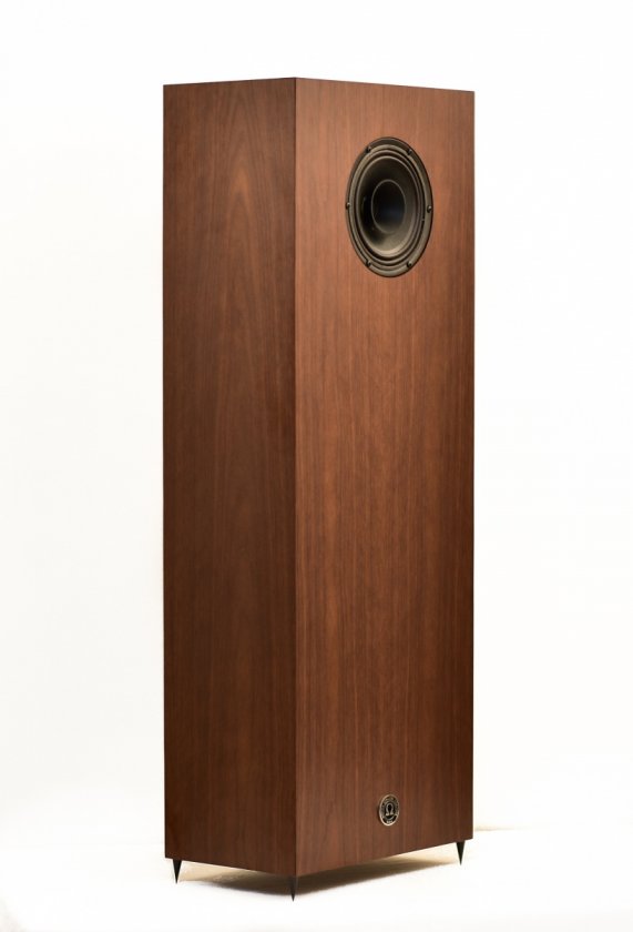

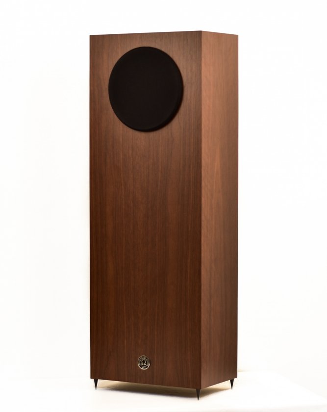

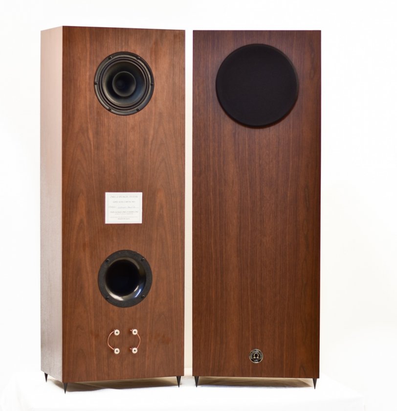

Hi All,
I wanted to share some pictures of a custom speaker I just finished in level 2 Walnut
It's a Alnico Bipole XRS and wired to run in either 4 or 16 ohm.
Louis
