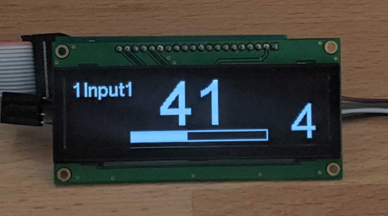

Morten - Can you post a picture of the new OLED display as it will display when the signal is sent to either channel through use of the balance control.  In my older one I get a digital readout of each channel all the time and it is easy for me to see how the balance is adjusted.  Let's say the old method would display   44 41.  What would this look like on the new OLED?
tortugaranger
  • Posts: 1780
    • Tortuga Audio
Re: V25 OLED Display
« Reply #50 on: 13 May 2020, 01:39 pm »
This example shows the nominal volume at step 41 but the channel balance is shifted +4 steps to the right. If the balance were shifted left the "4" would be on the left side of the display. For the V25 that's 4 steps at ~0.6 dB per step. When channel balance is neutral the balance number (zero) is not visible. Max channel balance steps is 20 left or right (12 dB).
In order to maintain overall actual volume level as the channel balance shifts left or right what happens under the hood is for every other step (an even step), the opposite channel will go down one. Hence channel balance is actually a channel volume difference at a given average volume level. To illustrate, see the following table for the +4 case
Master volume - 41
Balance Adjustment     Left Vol      Right Vol
             0                     41              41
             +1R                 41              42
             +2R                 40              42
             +3R                 40              43
             +4R                 39              43
