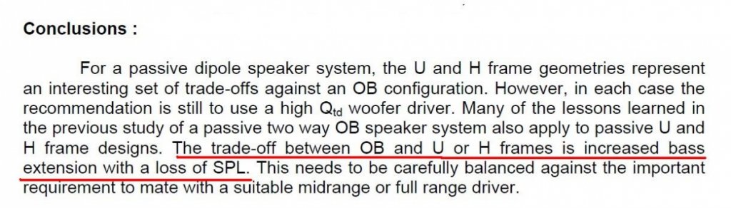

There is zero context of at what frequency his sim is calculation SPL and extension. That appears to be a table showing what the midband sensitivity loss of air mass loading the driver will be. That is not a sim of flat vs H and has zero dimensions or relevance. You have no clue what you are referencing.

fell free to contest the work of MJK ....the conclusion is clear ...a lot...is your problem!
you need 200w for H baffle vs 100w flat

I think you should read the paper more carefully - he is not comparing baffles of the same size.

If I were to guess what MJK is referring to, it's the simulated loss of midband sensitivity from increasing the parasitic air mass load on the cone when placed in a TL (the H duct). Nicoch has clearly demonstrated no knowledge of basic physics and is misreading and misleading, bigly  :D
