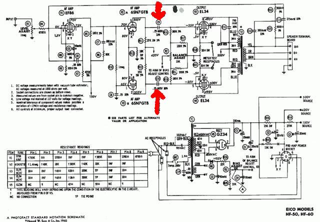

Can someone discuss the downside of PXLLO circuits? I've been given conflicting views. A lot of people here at AC seem to have no problems. But I was told..." Typically sub signals are filtered at 18-24dB/octave, not the 6-12dB seen in the passive designs. The insertion losses with the passive filters are a pain to deal with especially when dealing with higher roll-off rates."
I would like to implement a 80Hz high pass filter for the main speakers and through another out in my 2 channel preamp, use EQ and seperate amps to power 2 seperate IB manifolds w 2- 15" woofers each.
Picture- An example of the high pass  PXLLO circuit I want to use between pre and main amps.

I am using a Eico HF-60 as  a mains amp. Please elaborate how you would implement caps or resisters.
A cap calculator can be had here   http://www.pronine.ca/capimp.htm
Attached is the schematic.

try different xo  start 0,1 to down
lokie
Re: PXLLO circuit for Infinite Baffle
« Reply #6 on: 3 May 2017, 08:18 pm »
Awesome. Thanks for your efforts. You're a Prince
Just so I have this correct... change the C9 and C10 from .25 to .1 and adjust from there?
So if I wanted a higher xover point, I would try a .09 and below? And reverse for a lower xover point?

yes if real impedence is 100k with 0,01 start cut 6db from 150hz ....

150hz is too high. I'm thinking 80hz.
According to the calculator... I should use .02. Which doesn't seem right considering there's a .25 cap in there now.

There's absolutely no (good) reason for you to fool with your Eico amplifier to achieve this objective.
You should implement a simple CR filter outside the amplifier but fairly close to the input jacks.  (Just a small project box like the one you posted above.)  This has the advantage of easy fine-tuning of a shunt resistor value so you can use standard value capacitors.  It also has the advantage of allowing you to easily increase it to a second-order filter should you so choose.
The KISS method here is much easier/better/safer.
Dave.
Dave-
Have you done this yourself? What crossover point were you shooting for? What kind of subwoofer?
How do you increase it to second order?
There's absolutely good reason ie avoid another caps in series with signal ....great reason

lokie  6db is smooth transition if you want xo at 80 you must start to 150..btw have fun, test some caps...when you find the right one I can suggest a good sound one ;)
no need 12db filter
