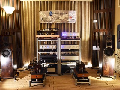

The evolution of these concept designs culminated in the Ambrose A30 mono block amplifiers, as production models. We determined that 30W was needed to drive a greater variety of loudspeakers, and the EL34 tube provided the right combination of excellent sonics, tube availability and reasonable build cost.
We knew that a single EL34 tube could produce a clean and low distortion (IMD and THD) 10W of VERY musical power.  Further research with Jack Elliano proved that the same could be done with two EL34’s in parallel for 20W, but at the time, three tubes was problematic, leading to oscillation and instability.  This initial research was done with Dan and Jack Elliano in July of 2015.
Early in 2016, Jack called Dan to tell him that he found a way to stabilize the Trio of EL34 parallel pentodes for a 30W Ambrose amplifier. Dan travelled to Vegas again to work with Jack and listen to the prototype.  It was GOOD and Dan felt that a sweet spot had been found. It was a clean 30W of power that did not require HUGE power transformers operating at 1200V and expensive 845 tubes.
Dan requested a special pair of output transformers designed for a 30W EL34 Ambrose mono block pair, capable of EXCELLENT low AND high frequency response.  This was a special design because transformer designs often require a compromise of bandwidth due to the physics involved in Single Ended output transformers.  More core mass was added and the design was revised by Jack Elliano to deliver what we needed.
The Ambrose A30 Mono Blocks were born. The A30’s possessed the sparkle, dynamics and lively sound of the 10W Ambrose AND enough power to drive a much greater variety of speakers.  It was also much less costly to build than the Reference 845 DS mono blocks, making it more attainable for a greater customer base.
(Debuted at T.H.E. Show, Newport, CA, in early June 2016. We knew we had hit the mark!)

Photo courtesy of Positive Feedback Online.
