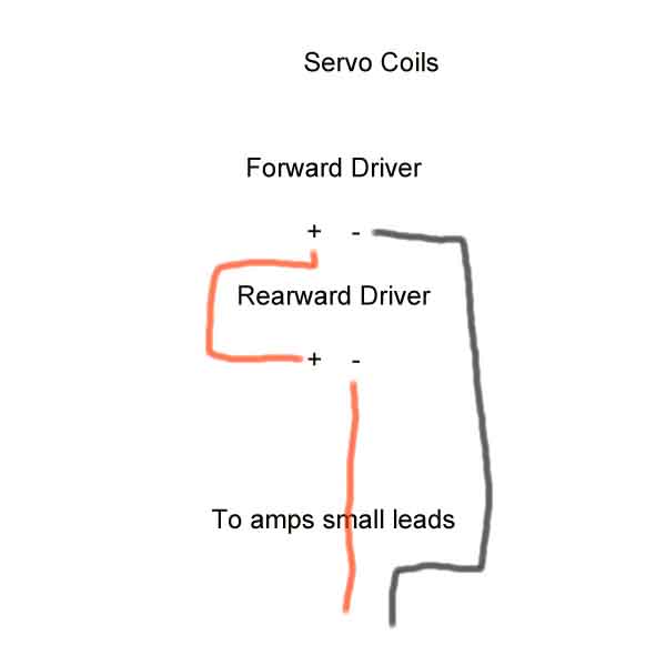

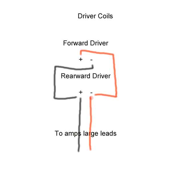

Re: GR-Research and Rythmik Audio 6x12 servo sub array
« Reply #61 on: 25 Jul 2016, 10:31 pm »
Here is my tip for wiring the drivers.
At the amp end, wire both set of drivers as if the are both front firing.  This means the drivers are in parallel red to red, black to black.  Wire the servo wires in series with one red and black wires from the pair connected together.
Wire the forward pairs as normal.  Wire the reverse pair with all the wires colors swapped.  When you get to wire 12 of them, you look for a simple visual method and it works.
Give that a try if needed.

possibly even easier for duals with one forward facing woofer, one rearward facing woofer :
jay
« Reply #64 on: 25 Jul 2016, 11:13 pm »
nice. that look like even an idiot like me can follow. :wink:
« Reply #65 on: 25 Jul 2016, 11:20 pm »
Nice Jay, that should help anyone who has a question. Of course now everyone is mounting them in the same direction :dunno:
« Reply #66 on: 25 Jul 2016, 11:30 pm »
Not everyone is facing them forward, so we are here for the ones that do not.
« Reply #69 on: 26 Jul 2016, 12:54 am »
cool Hal. That works for me. Thanks. I really hope the wiring is the issue, because I was drooling when I read all the reviews, then I got and was like 'what?'. If I go back to Maggies, I think the bass as described would be perfect. My old Maggies got stand up bass on jazz flat out right. Better than anything else I ever heard. But they had no 'slam' on rock stuff. And I like to rock out. I have no neighbors except weekends (B&B next door) I'll play the Chile Peppers or Floyd, etc at the limits of speakers sometimes if I want. (hey not all the time. I have a part, part time job as a front of house mix man. I value my hearing. I'm good at it because I can still hear. Plenty of guys with more tech know how in town, but they're all half deaf.  :evil:)
If they are not wired properly it will definitely make a difference. If you have one driver facing forward and one rearward and forget to reverse the polarity on the driver coils the drivers will cancel each other out and you will have almost no output (three guesses as to how I know that and the first two don't count  :oops:).
If you get the servo coils wired wrong you won't have much low frequency extension or be able to handle much power before the drivers bottom out (Yeah, done that too  :nono:).
Mike
