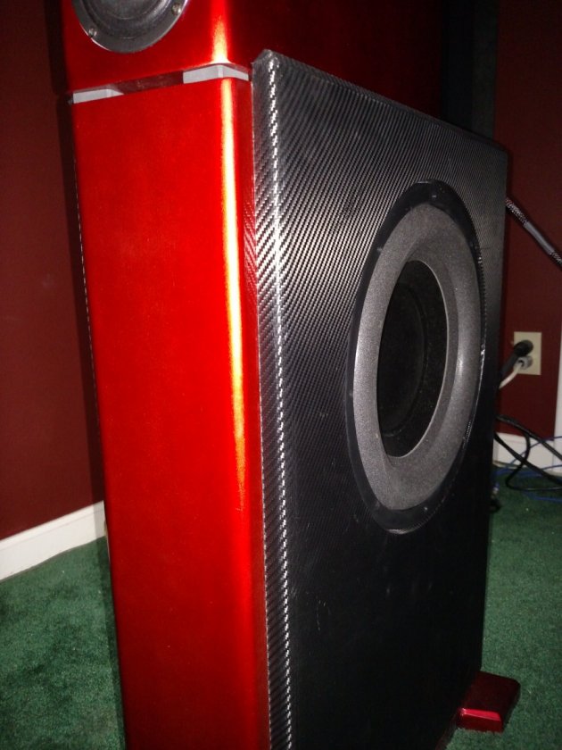

Hey Jay.  I'm certainly no expert but I did just complete my wedge bass units with paint and vinyl wrap.  The wrap I used was 3M 1080 series.  It worked out pretty well.  If you are transitioning corners in more than 2 planes I would highly recommend getting enough to play with and get a little experience with it.  I learn more each time I use it.
Regarding the adhesion promoter, I used it on my entire project.  My best results were achieved when I let it dry for 24 hrs.  You don't need much, a little goes a long way.  I picked up the  8oz 3M adhesion promoter, did an amp base twice and the wedge bass units and still have a half can left over, I appilied it with a foam brush.
I have the wrap bumping right up against the side of the red board on the subs.  I would recommend having some kind of transition between the paint and the wrap, but that is a preference and certainly not a requirement.
Mike is correct, the vinyl doesn't hide any surface imperfections, so you will want to prep as if you are painting.
I'll be happy to answer any questions you have if I can.  I would say go for it.  It is not too expensive, reversible, and I think it looks pretty good.

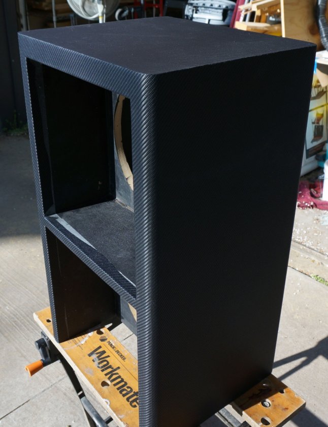

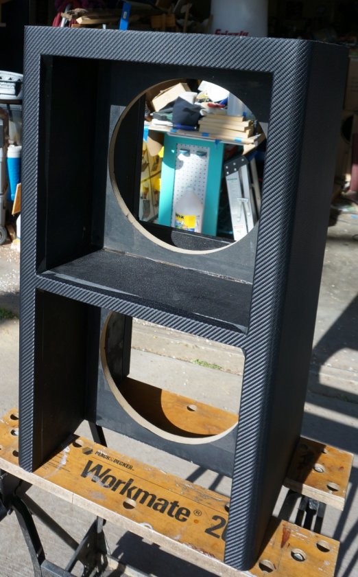

Here's how the Tolex I used came out:

« Reply #7 on: 20 Apr 2016, 12:15 am »
Looks pretty good from here Mike!

« Reply #8 on: 20 Apr 2016, 02:21 am »
Best
Ed
Thanks Ed. That was the second type I used. Tolex is much thicker than the thin wraps. It's the stuff a lot of guitar amps are covered with.

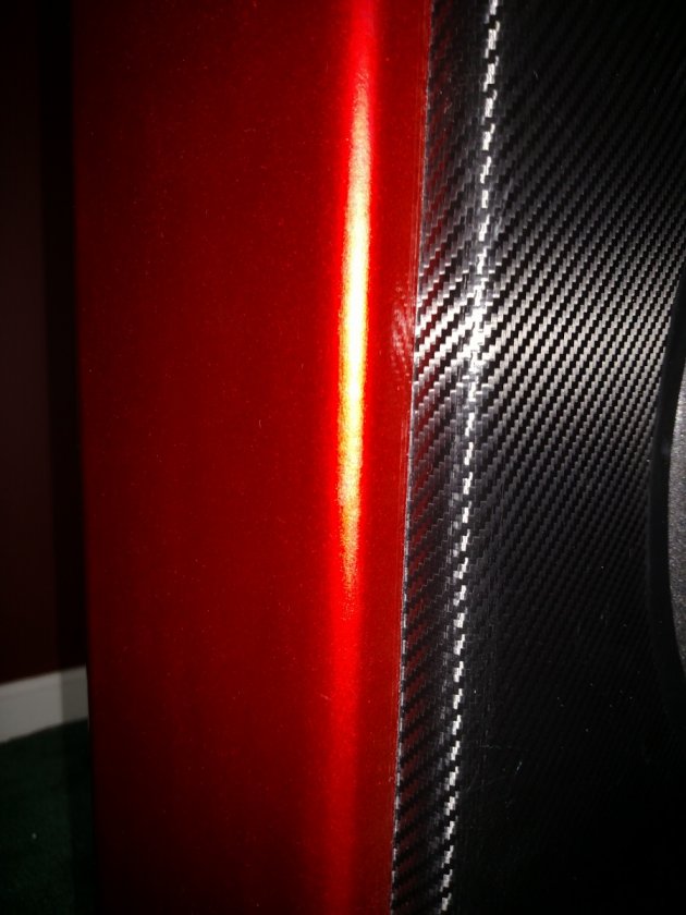

If you have a chance, could you post a close up of the transition between your wrap and the paint  ?

ebag4
Re: Viynl Wrp
« Reply #13 on: 20 Apr 2016, 11:45 pm »
Ed, I'd only be  going over a roundover in one direction, basically a side  to a front or rear edge.
 Cool :thumb:
jay
Here you go Jay:
Best,
Ed

Jay,
The Tolex was probably two to three times thicker than the wrap. The recommended adhesive is 3M Super 77 Spray adhesive (or equivalent). That's what I used for the entire cabinet but I had to go back and use a brush on contact cement on the pieces that folded into the driver cavities after the fact.
I wrapped each cabinet with one big piece going around all four sides. to keep the contact cement from grabbing before I wanted it to I put wax paper over the cabinet before putting on the Tolex. Then I pulled the wax paper out as I went. Kind of like peeling back PSA lining as you go. I applied the adhesive to a side and it's corresponding piece of Tolex one side at a time. I used newspaper and masking tape for each application to make sure I didn't get adhesive where I didn't want it.
Then cut out the openings and glued down the edges. Finally I glued a separate piece on the top.
Mike

That really helps show how thin that material actually is Ed, also shows you get a pretty  dam good  edge on it, appreciate the pics.
