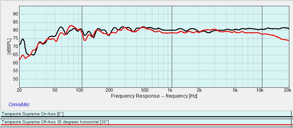

1/12 octave smoothing and showing room effects below 200hz. The 100-200hz area is the floor bounce reflection. This is the sealed box option.

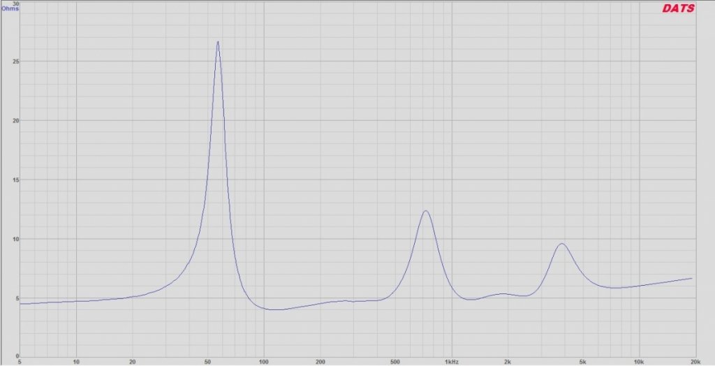

This is the sealed box impedance which averages 4.5 ohms and only dips to a minimum of 3.97 for a reasonable amplifier load.  :thumb:
