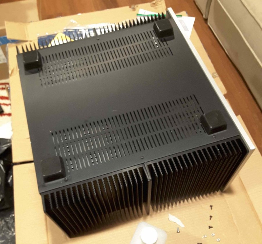

Im trying to attach feet (herbies product, black rectangles, no longer on the site) to my chassis.  I've had no luck with the few I've tried- the adhesive doesnt stick to the feet.
Right now I'm trying some GE silicone II, but I'm not overly hopeful.
I need them attached since, I plan on hive the amp around.

Well it is adhering (silicone caulk), but not very strongly.   I'll give it 24 hours before I try something else.

The issue in running into is what will stick to Herbies material.

Here are links to adhesive that is recommended on the Herbies Audio Lab site .
Small spay can of Hollister medical silicon adhesive = https://www.brucemedical.com/holmedadandr.html
And small bottle of Secure 2 medical silicon adhesive with brush on applicator =
 http://www.factor2.com/B_460_B_461_B_462_Secure_II_Medical_Adhesive_p/b-460.htm

i thought herbie recommended automotive blue rtv?
ive been using this for years, i thought per his instructions...
