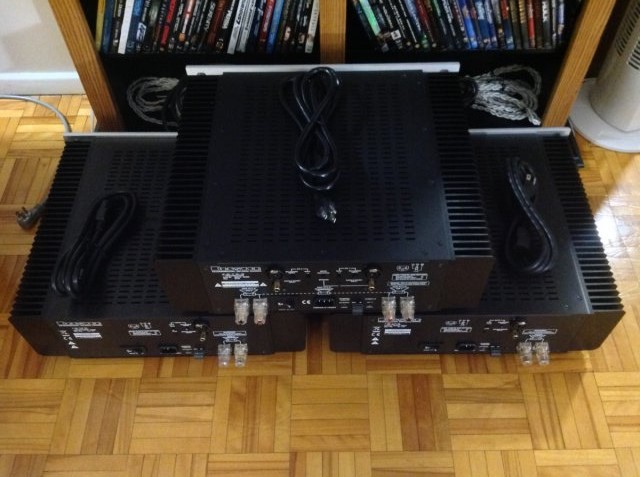

Here's a shot of the amps awaiting hookup. That's my 4B-SST C Series on top that I'm putting back into service. These will replace my 6B-SST C Series which I'll probably sell. Once I get my XLR cables and get the LED's in I'll put the amps into their new homes.
