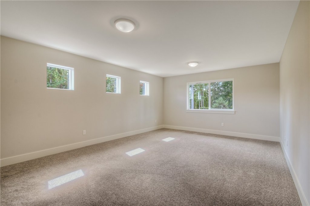

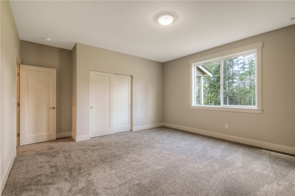

I was thinking of placing some 1.5 inch fiberglass panels, that are 2x4 feet on the ceiling at first reflection.  Also to do so on the side walls and back wall.  I here's a before picture, still in the loan process and won't close until the end of March.
Larger rectangular room:  (taken from the entry to the room)
Squarer room with the 9 feet ceiling: (taken from the corner of the room)

I would take the longer room.  It gives you a lot more flexibility in seat and speaker position to get the best starting response and keeping the modes spread out more evenly rather than a squarer room.

I would go for the longer room, you are pretty close to the Cardas rule so it should be a much better space than a square.

Hi Sonny,
Looks like you can sit a decent distance from the rear wall, which opens up a lot of possibilities, whether it's diffusion or absorption (or some combination of the two). You'd probably want to start with 16-24 sq ft of diffusion for the rear wall (looks like there's a door in the corner, so focus on the middle section), for which you could consider a QRD-style diffuser (http://www.gikacoustics.com/product/gik-acoustics-q7d-diffusor/ or http://realtraps.com/diffusor.htm). There are also polycylindrical "diffusers," though one starts to get into semantics about whether they simply scatter sounds in different directions without changing phase/time as "true diffusion" does.
There's a basic representation of how a little absorption and diffusion might affect your perception of music here: http://www.wghwoodworking.com/audio/LoudspeakersandRoomsPt2.pdf
If possible, consider 3-4" absorption panels over thinner ones like the 1.5" you mentioned, especially for first reflection points.
