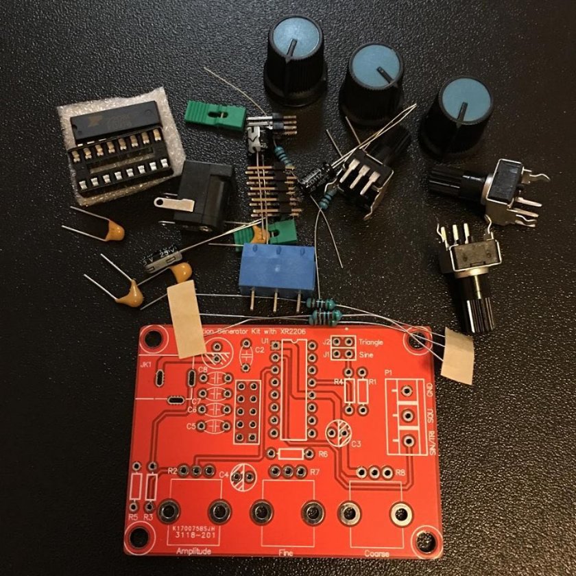

I saw this Function Generator Kit on Facebook. What can you tell me about it?
Is it available now?

Oh, that is a kit I bought on AliExpress. Not a high performance stuff, but it will be ok for an occasional use outside of the lab. Important to note is that output has DC offset, and a capacitor needs to be added between the generator and audio inputs.
Here is the link:
https://www.aliexpress.com/item/XR2206-Function-Signal-Generator-DIY-Kit-Sine-Triangle-Square-Output-1Hz-1MHz-Signal-Generator-Adjustable-Frequency/32846861578.html?spm=a2g0s.9042311.0.0.27424c4dntkpHj

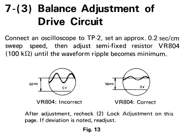

What I'm trying to figure out is how I'm going to set 4 trim pots in my turntable restore.
The kit looked interesting to me when I saw it on FB. I've never used an oscilloscope before and I don't know if it
would do what I need in the 3 photos below.
I'd appreciate your thoughts.
